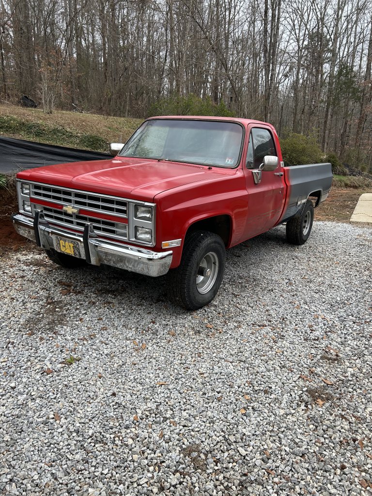

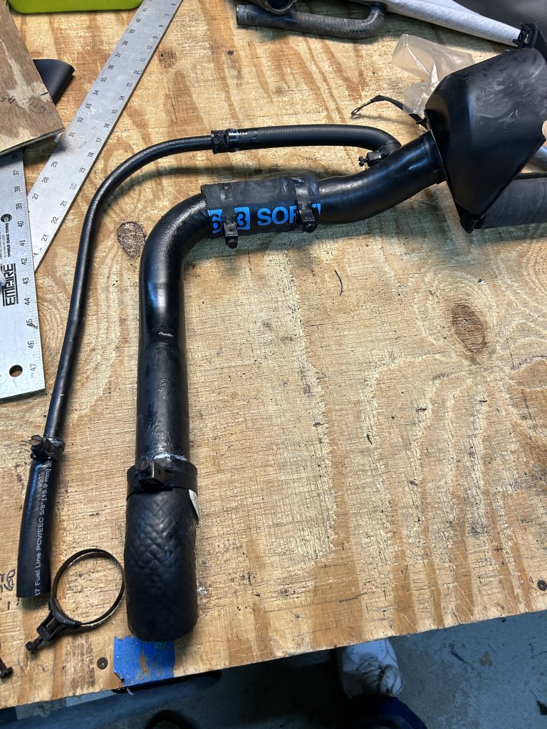

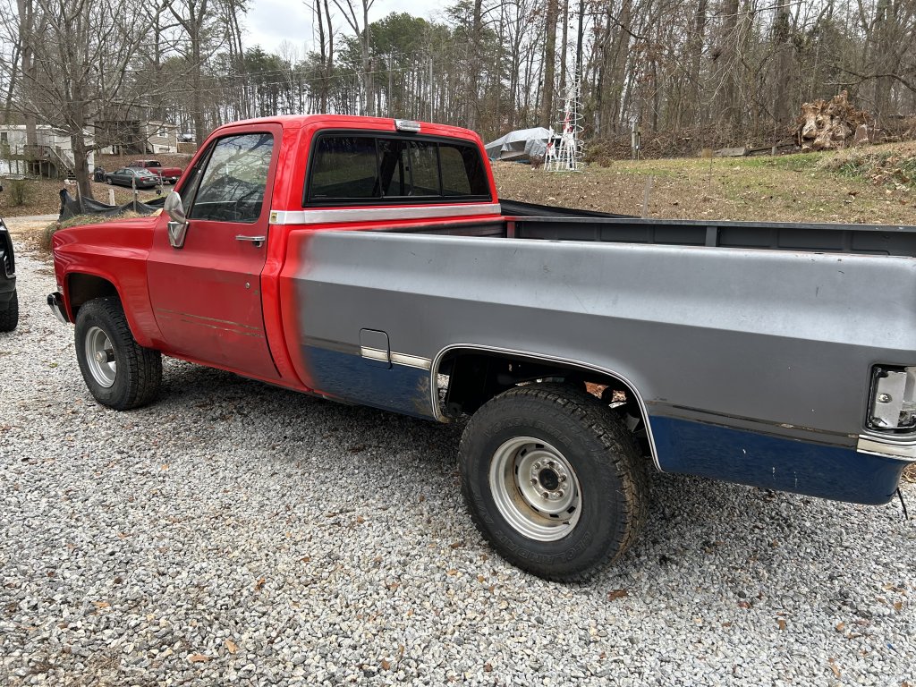

Put my bed on finally .re did the fuel filler pipes on both sides , Pre prepped my cab and bed with paint . Now move forward with bed sanding and sealer . Wow what are Christmas vacations for anyways ..
