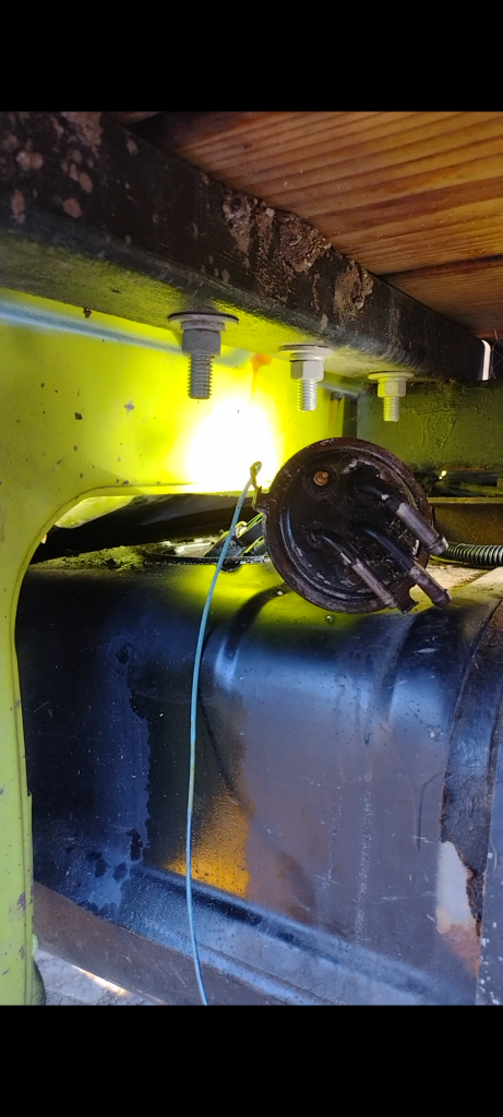

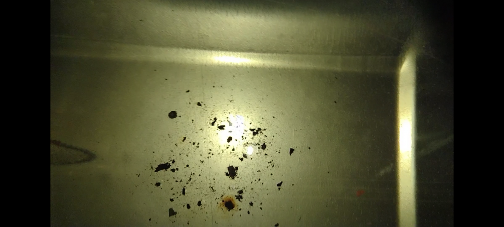

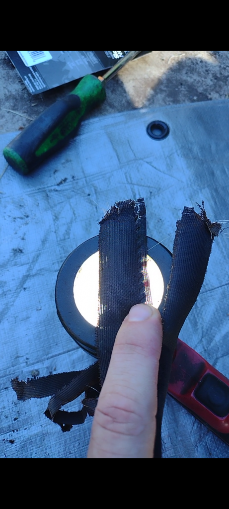

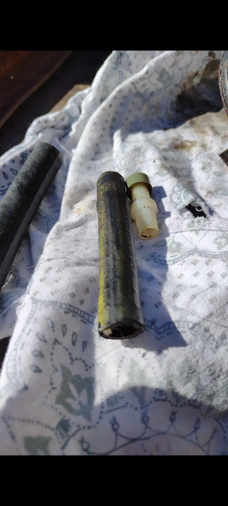

Trucks been acting up when you get on it would cut out pulled the sending unit and tank was pretty clean except for a bit of the old sock in the bottom deleted the sock(have filter inline before the pump one before the carb and one in the carb as I didn't know the tanks condition until now) I also found the vent was completely gunked up with mud cleaned it up with some compressed air and now it runs good again

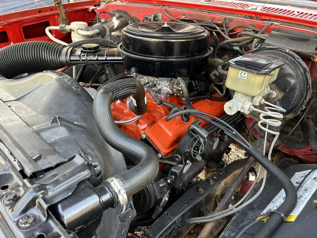

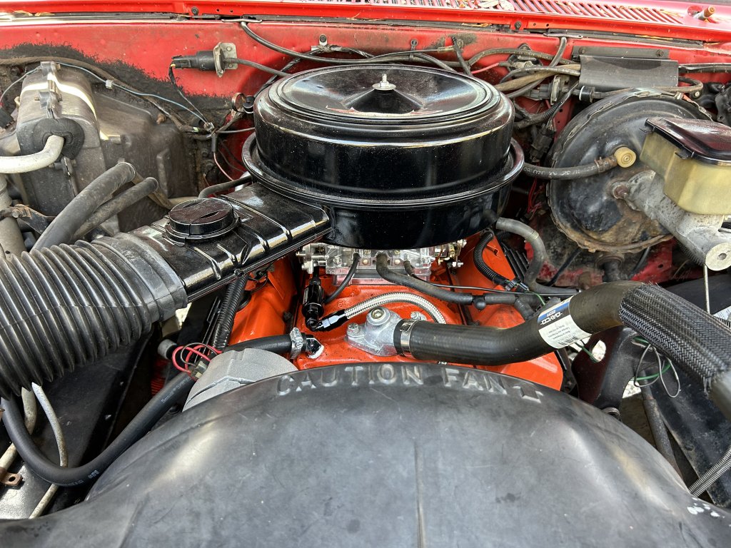

I was able to keep my original Air cleaner ..after my carb and distributor swap . I am so glad I love the original cleaners and the tall element , oh yeah forgot to mention I used a spacer on top of the carb!
