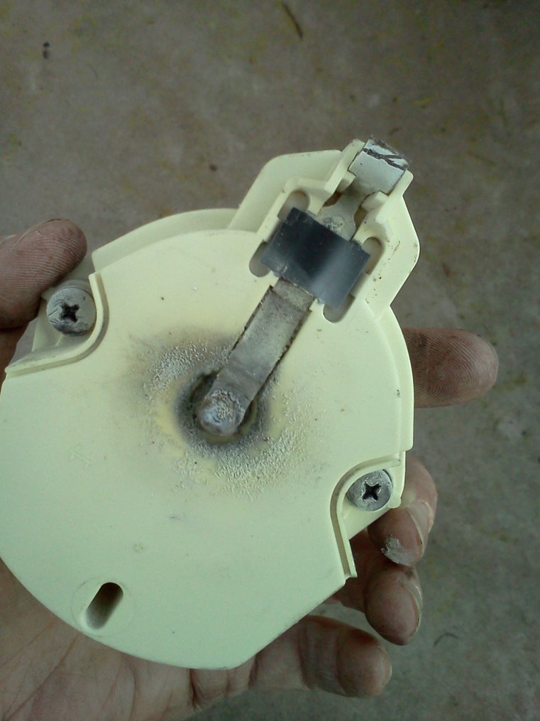

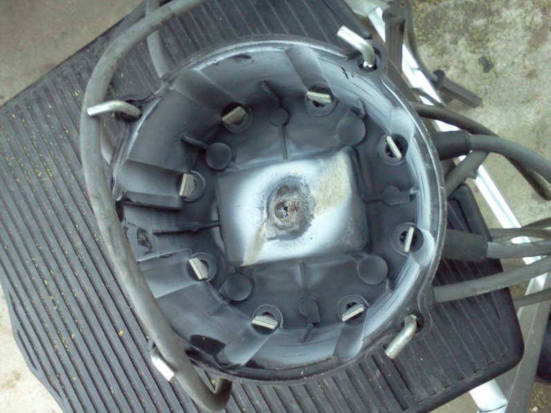

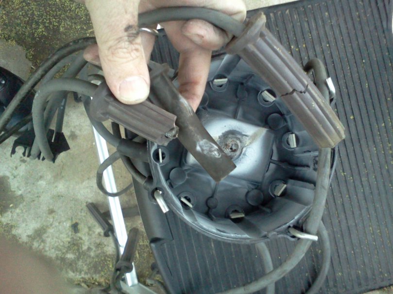

Found out why it was running rough...

Damn, Did you say running rough, or NOT running? :insane:
Had a bad miss last time I drove it on Friday. Went to start it on Saturday and it started, stalled out, and then nothing. When I went to pull a plug boot to check for spark it crumbled apart in my hand.
Until that happened I thought it was the carb acting up again.
I had it on the list to change out the plugs and wires, they were just a LOT worse than I thought.
I'm replacing the cap, rotor, plug wires, plugs, and coil. I may replace the connector ends that plug into the coil through the cap, too, if I can find 'em in the parts store.
High black carbon content in the distributor cap and on the rotor, or, burnt, is a sign of too much resistance downstream, meaning plugs or plug wires.
I guess this time it was mostly from the wires huh. :boxed::rotflmao::hidesbehindsofa:
