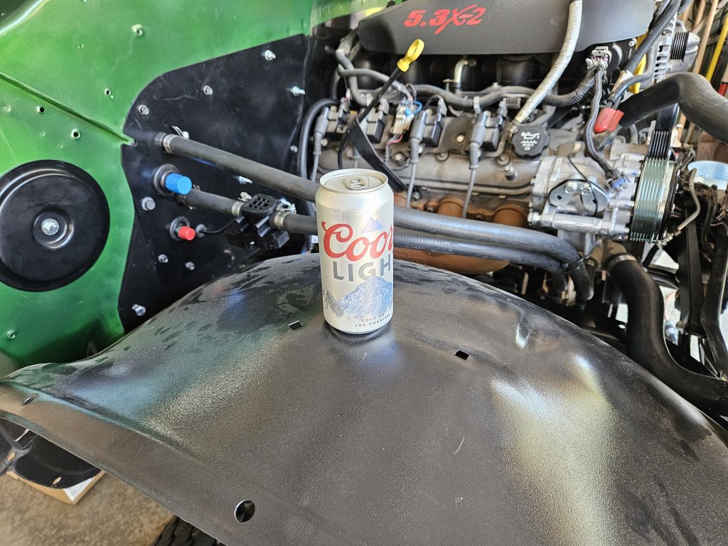

@CalSgt thought about your mounting issues with the vintage air I cheated, had some 1/4 20 one inch bolts, spun them through the mounting plate and made them studs! Thanks for the heads up for the headache!!
