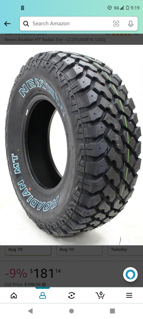

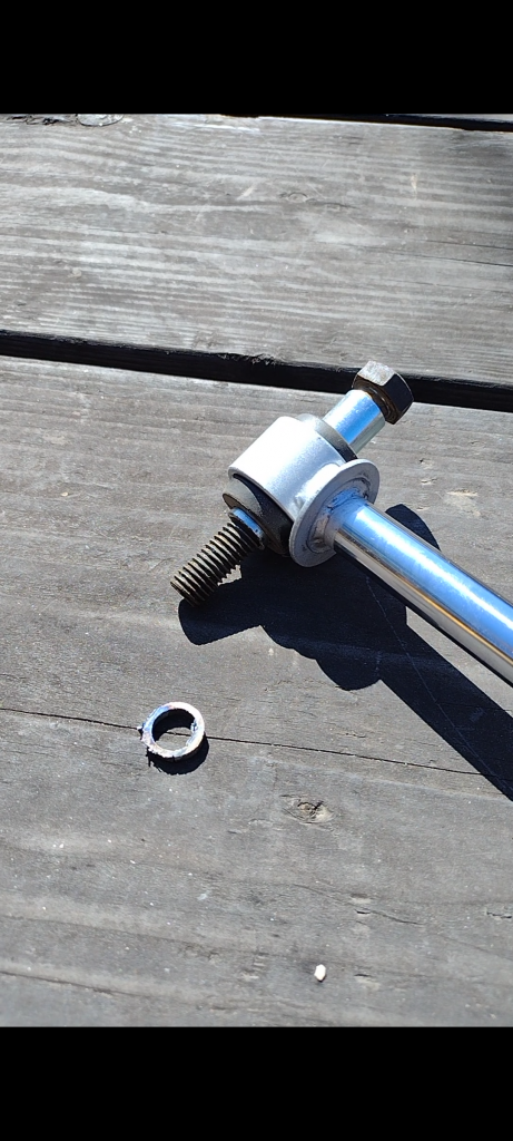

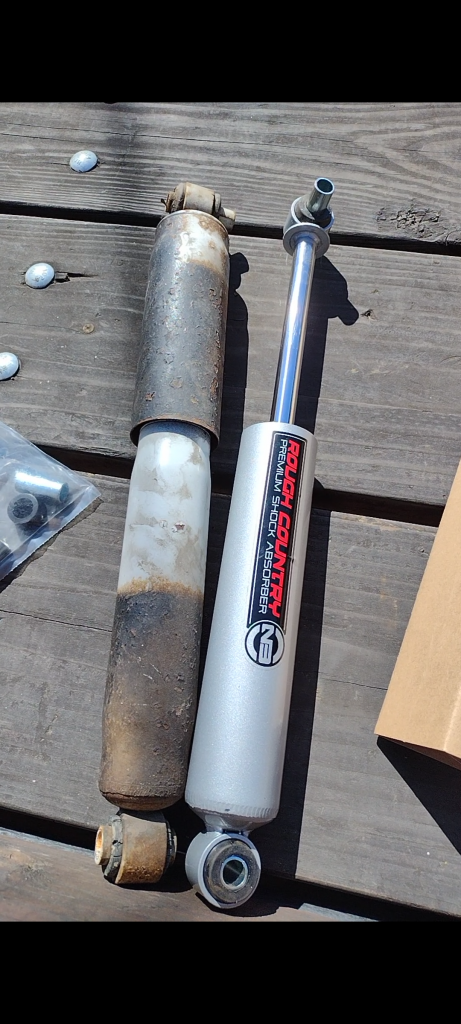

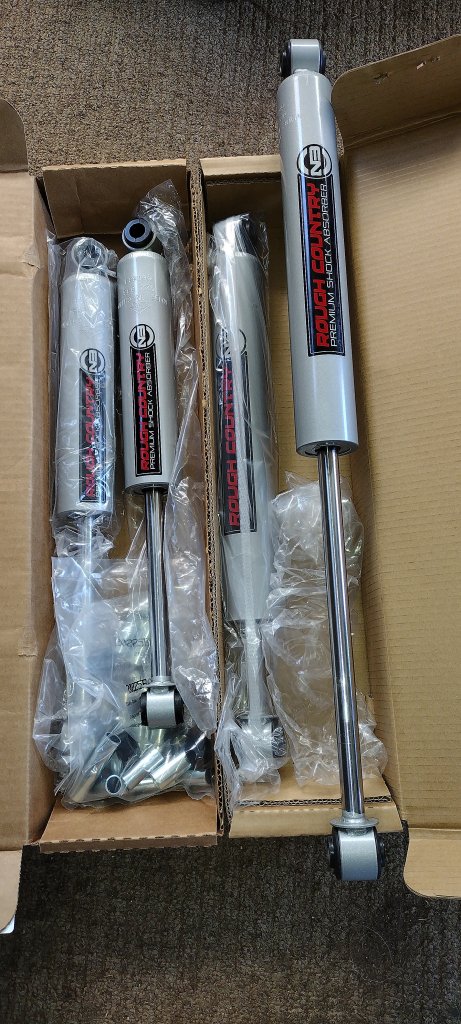

Got some shocks and ordered some tires for the old girl

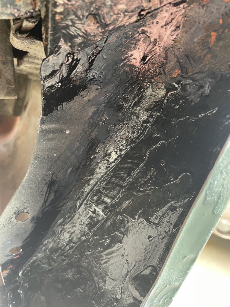

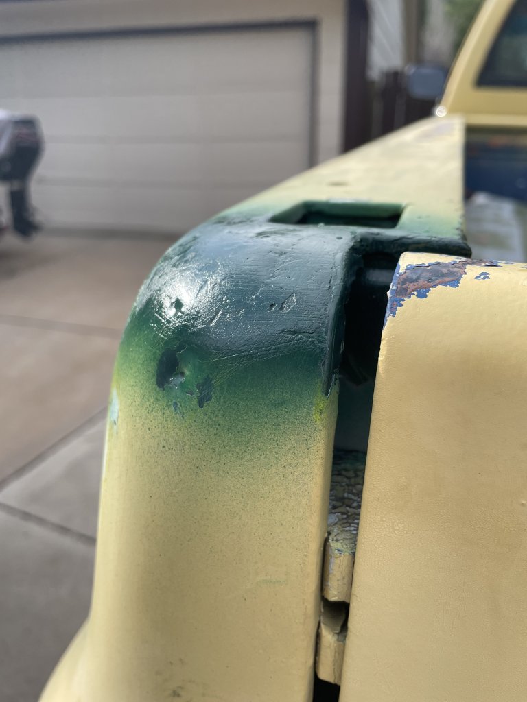

Por15 the inner box supports which I just patched. I also pushed out a few dents on the driver side box panel. PO stuck some bondo in the deep dent which was separating from the metal. I was able to get at it from the upper tiny access near the tail gate latch.

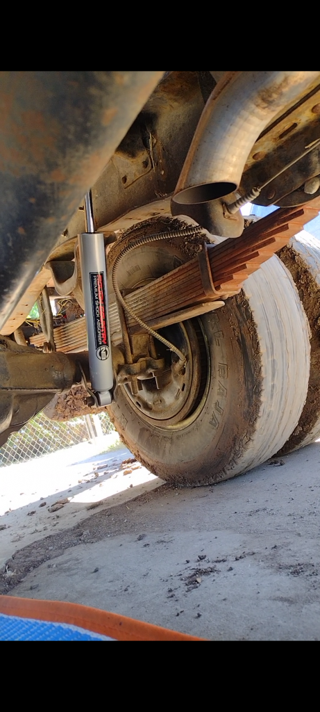

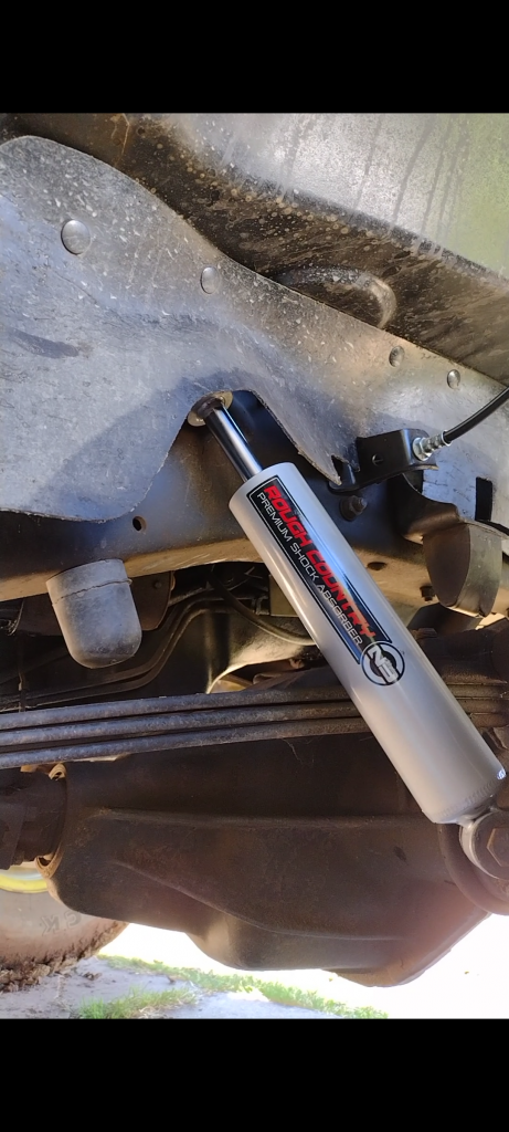

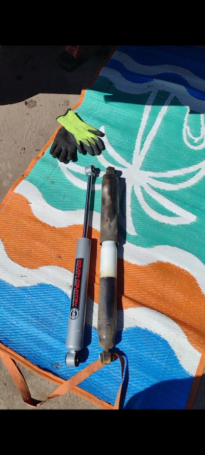

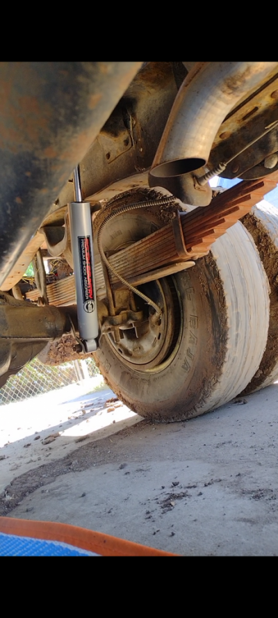

Got the shocks in had to trim the spacers for the front gonna go test drive it now

Looks like you could use some more aggressive tires to help out your get along wherever it is you've been gettin along.
I almost trimmed the spacers for my front shocks as well. Then I realized that the tabs were slightly bent inward. Gently pried the tabs back straight and the shock slipped right into place. Easy as putting socks on a rooster!
That was on the bottom mount though, I didn't have any issue with the top.
It was the front upper mount I just went off the spacer thickness from the shock I took off either way it's riding really good didn't think a leaf spring truck could ride so good
