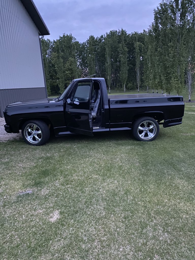

Getting leather buckets and console out of a avalanche, black interior panels, supercharger or twin turbos, and a 6 speed transmission

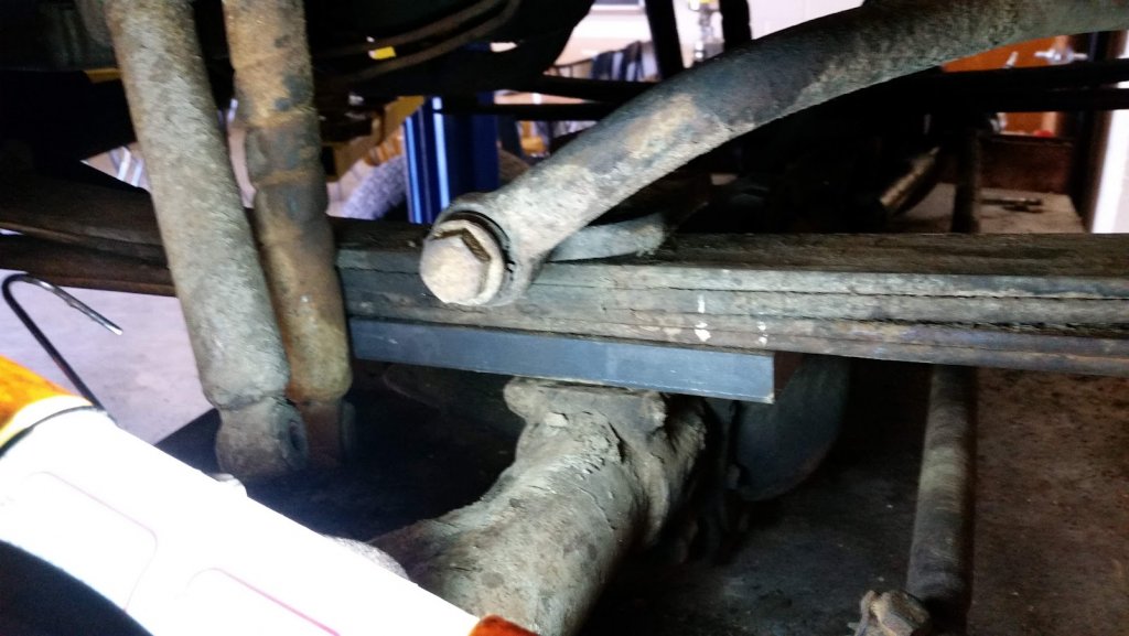

Here's a pic of how I added an inch to the front leaf pack on my '81 Sub K20. It's a slab of 1" steel that is 10 inches long. I drilled the center and put the spring kingpin to go through all the leaves and the added "block". Most blocks have a locator for the axle/spring but do not attach to the spring itself.
