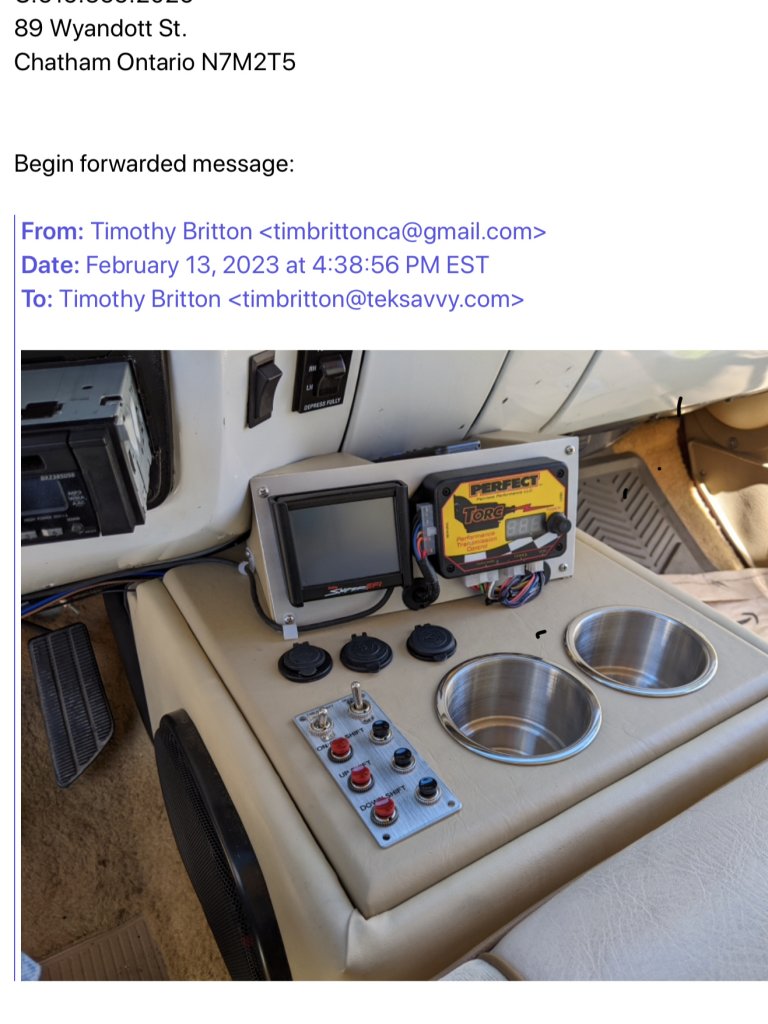

Dropped in a4l80E. What is the easiest way to still use the stock column shift and safety neutral switch. Any ideas?

Also because I installed a sniper efi and now the 4l80e Ihad a couple of controllers knocking around the floor I built a console with shift switches and cruse switches and something I always wanted cupholder
Which transmission controller did you use?
