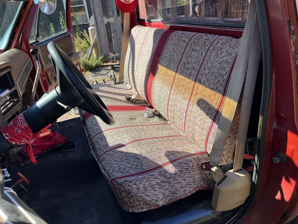

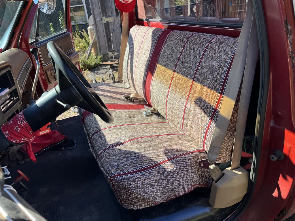

Put the “new” seat in with the new seat cover. Will hopefully help with the 0 degree or below mornings going to work. The old vinyl seat was rough to sit on, especially with a non insulated cab with plenty of drafts and the old heater motor that barely blew anything. This winter will hopefully be more comfortable.
Also, putting this seat in made the shoulder belts fit much better since the bottom cushion has the holes in it for the latches to come up through instead of the gap between the back and bottom. Not when I fold the seat foreword, the belts stay put.
