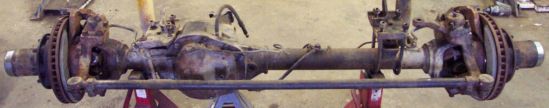

It will have outer axle u-joints no matter what solid front axle it is. Dana 60 kingpins are in place of balljoints. Here's a pic of my D60 cover...

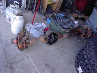

dana 60 click the thumbnail
i think dana 60 went from 73 threw 91 in 1 tons
maybe earlier than that but i am not sure

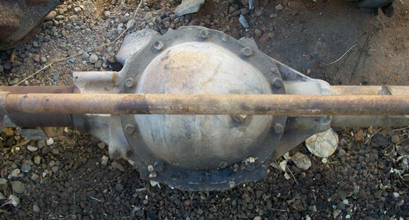

10 bolt is easy egg shapped cover
i think 81 was the first year for the 10 bolt
