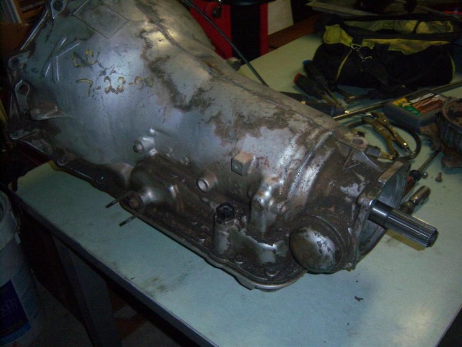

Here is a 700r4 with the OEM 4x4 output shaft. Ready to have any OEM Chevy Squarebody Tcase mounted to it with the correct OEM adapter, and NO spacer.
attachment.php

I wish I had a Th350 OEM 4x4 output shaft to go in this pic. This is pics of the 6in, 9in and the modified cut off 2wd output shaft that I made to make my Th350 the same case length as the 700r4. I know there is only 1 OEM 4x4 output shaft for ALL years no matter which Tcase, NP203, NP205, NP208, NP241C and NP241C was never mated to a Th350 either, but cuz it's the same adapter as an NP208, it also works.
attachment.php
