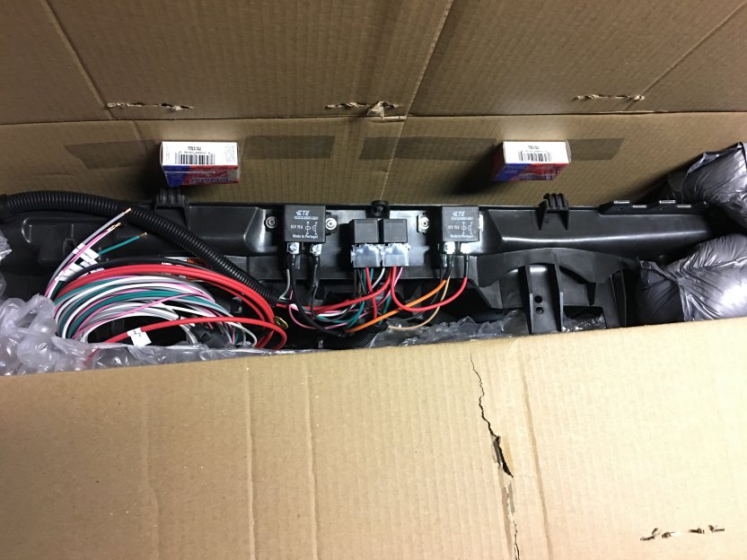

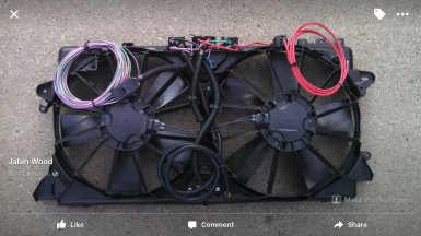

I just built one for a guy last week and shipped it out-the dual 14" fans are rated at 6000 CFM and I would suggest running at least a 140A alternator as this setup will demand 36-38 amps on high speed. I build them as a parallel running 3-speed configuration using my dropping resistance style relay control harness. It measures (with side tabs trimmed off) 32x19x6.5 inches.

That's a sweet set up. I was going to ask if the stock alternator was enough to handle the loads of dual fans, plus fuel pump, computers, and dual a/c systems........my hunch was; probably on the ragged edge of it's ability.

Well keep in mind that a lot of aftermarket fans don't draw as many amps as OEM style fans-so you may be ok with a stock alternator-as long as it's at least 100A. I prefer to use OEM fans mainly from a durability standpoint-the one in the pic is a 2010-up F150 ( I know, I know....lol) fan assembly from Motorcraft. It's the most powerful setup at 6000 CFM that I could find-and this thing is insane on high speed-I bet in neutral it'll pull you to at least 15 mph!
