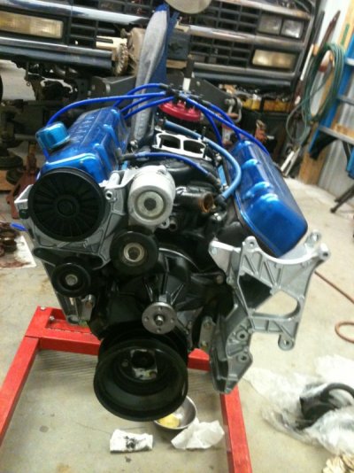

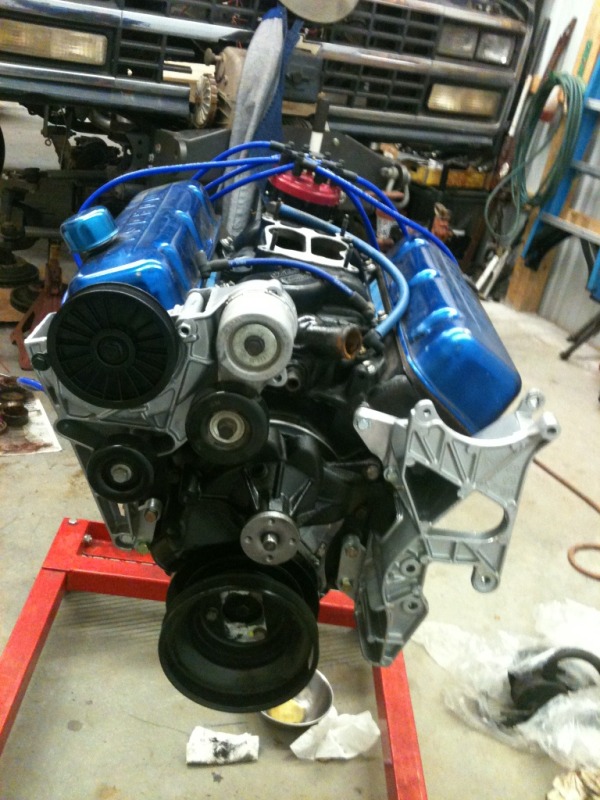

The aftermarket billet aluminum water necks can be rotated 360 since they are multiple pieces, the valve cover clearance may still be an issue however.
Or you could get a billet neck (because shiny) that points straight up and run a sbc upper hose.
Scruffy49
Law Enforcement Navy
Feb 28, 2025
418
589
Rosemark TN
Jeff
C10 swb
4.3L
The GMT 800 stuff applies if it's a 4.3L V6. That stuff still swaps over to the older small blocks.
Can verify, as our 85’s “new” engine is a 1979 date coded 350 crate engine, with 1992 350 waterpump and serpentine system. Ran it for a decade in a beater Z71 that now has a rusted through frame…
