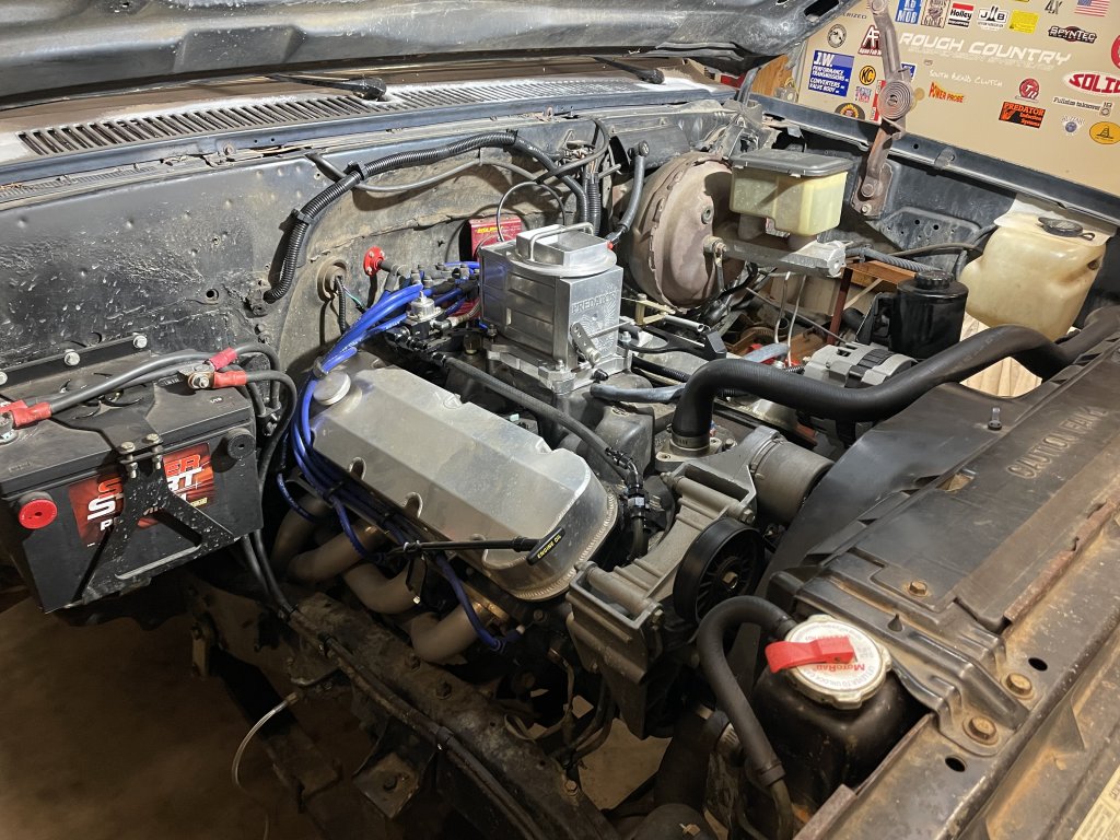

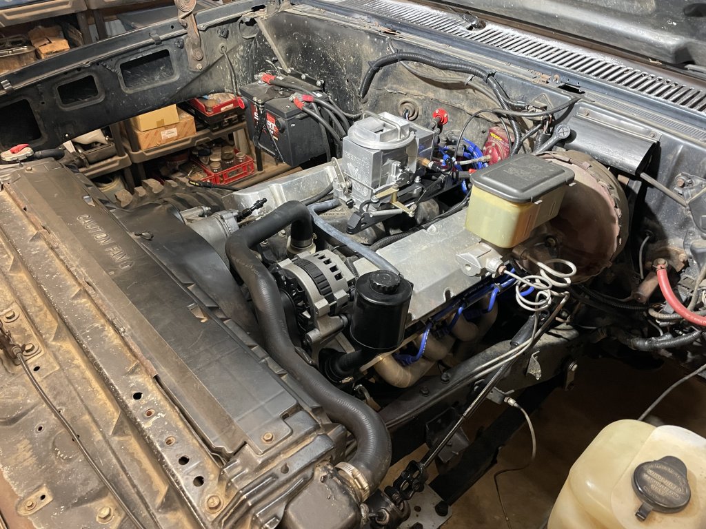

The aftermarket billet aluminum water necks can be rotated 360 since they are multiple pieces, the valve cover clearance may still be an issue however.
Or you could get a billet neck (because shiny) that points straight up and run a sbc upper hose.
