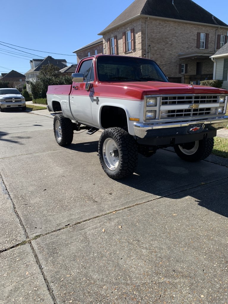

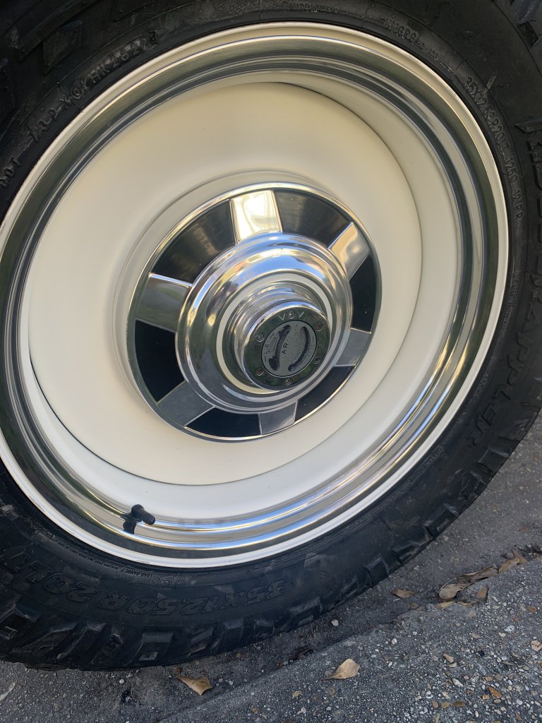

I just got my new rims on yesterday. Forgot to give the tire shop the hubcaps, the rear just snap in place but on the front I have to remove the Warn hub to get the cap on first. Is this correct? Or should the cap just go over the top without removing the hub? The hub cap sits in-between the Warn cap and the components but seems to fit well, all the Allen screws line up and go on easy. I’m just not sure if it is supposed to be that simple or I’m I missing something? New to 4x4’s this is my first classic / square. Thanks for any advice.

That doesn't sound right at all. The Warn hubs should be the same diameter as the OE hubs. If your hub caps are factory original, they should have a little room. They should not fit perfectly flush around the hub like your pic shows. Are those aftermarket hub caps?
You cannot have a situation where you would have to disassemble the front hubs to change a flat tire. That would be ridiculous. If you have to, sand out the center opening on the hub cap.

Those wheel centers/covers need to be clearanced. There is no room between the hub and cover.

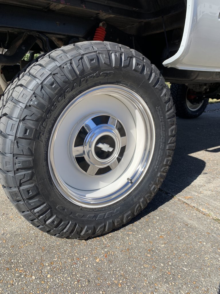

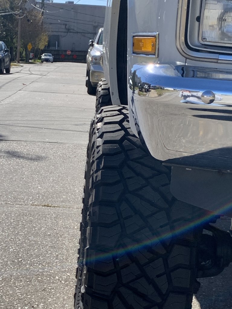

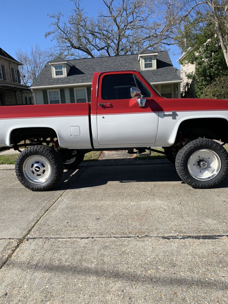

@gritdog it’s a 1/4 ton SWB with 1 ton axles. I need the lager hub caps to clear the 8lug axles. The five spoke hubs are much smaller a mistake that DSW helped me figure out. Thanks I would definitely appreciate you checking your clearance before I start widening mine out. I found the caps on eBay and polished them up pretty decent with a Dremel. But they are far from perfect.
Rims are 20x9 4BS DSW steel wheels in flat white
Tires nitro ridge graps 35 x12

Looks awesome! I got 3.5 BS, hoping that extra 1/2” sticking out don’t look too bad. Yours looks just right.
I cheaped out on the trim rings. For now anyway. Love the look though.

But per the info you provided and the pics, if you have 1 ton axle up front (kinda looks like a D60 cover in the one pic) then that is the problem. The hubs are larger dia and longer than the 10 bolt/ D44 in the 1/2 and 3/4 tons.
There are hubcaps specific to the D60 1 ton squares and the knock out is larger diameter and also the “cone” around the hub is longer or deeper That’s why your hub sticks out so far from the hubcap.

@Grit dog i measured earlier your 3.5 the hub cap will be right at the rim they shouldn’t stick out. I have 1 1/4” to the edge. Yes it’s a Dana 60. I didn’t realize they required different hubcaps. Find those was a pain in ass. I also already had stickers made to cover the gold.

Yup that’s it. Need 1 ton hub caps. Or they look just fine like that imo. If you can clearance them neatly.
