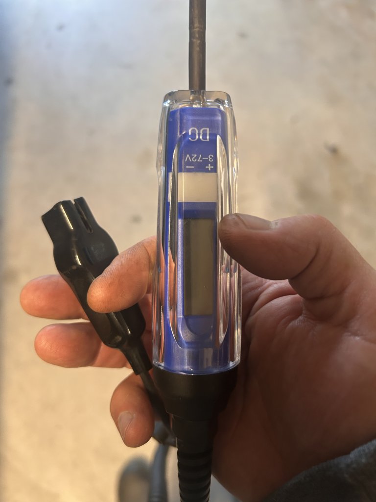

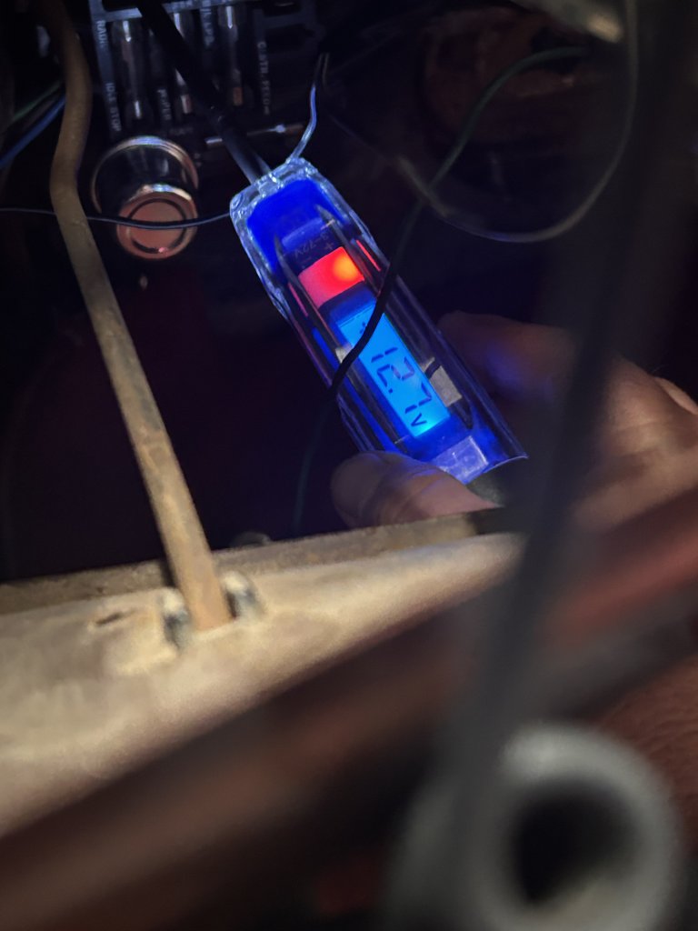

I have a single wire electric tester that quickly diagnoses some common dash and wire issues. If you hook it to (-) it will light red and display the voltage. if you hook it to (+) it will light green and give the ground voltage. I used it to find that I had 12v on the gauge connector on the panel. It turned out it was a bad gauge in my case. Alternatively, you get some 25-30 ft (retractable) test lines. Hook one up to each (+} and (-) and swap between them to find grounds and power.

Just use a multimeter. If it shows negative voltage your red.lead is on ground and your black lead is on power. And no need for 25 foot test leads you can pull power or ground from fuse box, cigerette lighter,etc. A useful tool is grab an old cigerette lighter cord ,cut the cord ,strip the wires put insulated alligator clips on them. Now you have a convenient power and ground in the car.

True. So not so good info, oops
