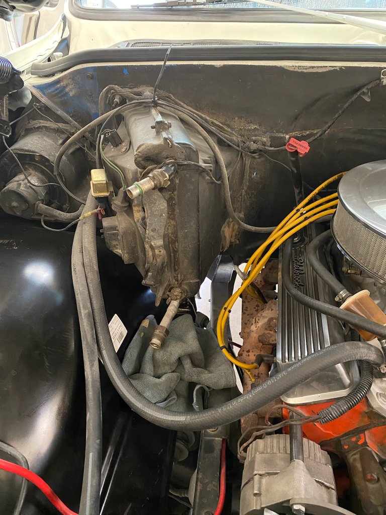

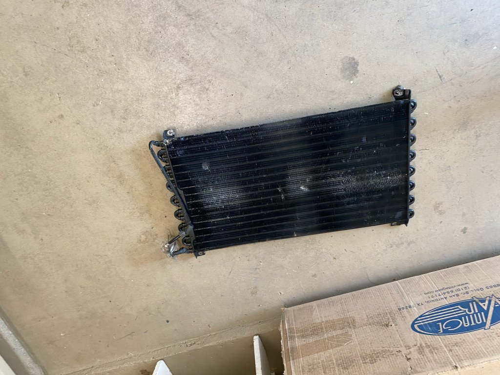

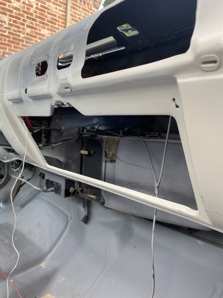

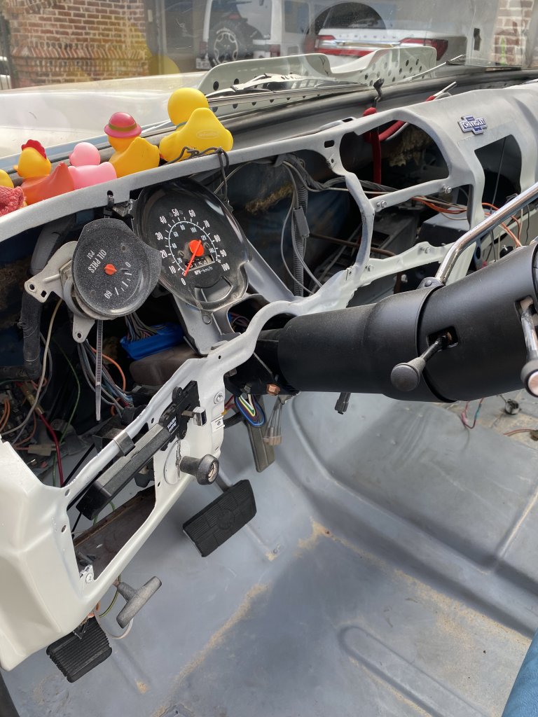

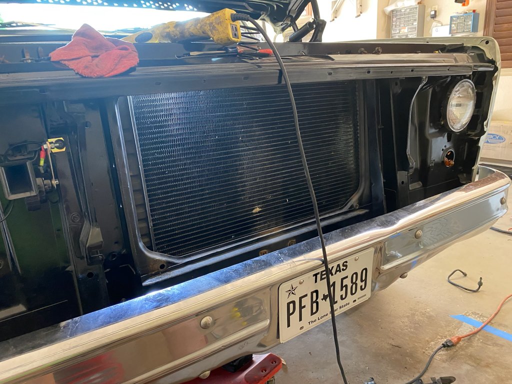

This was a good thread. We bought Easton Vintage Air for his 16th birthday and his plan (his budget) was to pay a local hot rod shop to do it… well, we are having trouble imposing on this guy that has helped us so much the last year. We thought by letting them do the vintage air we could pass back some for all the advise he has given Easton during this project at no charge… they local vintage air distributor here said $2500 and 5-7 days to do it. E. Said no way… so unless we get some response over next week or so looks like dad and son will be tearing his square down and doing it ourselves…..
Been watching videos and going over the installation manual for some time.. we are scared but at the same time, fairly confident we can do it. Then find a local shop to vacuum dry and charge system is all we will need hopefully….

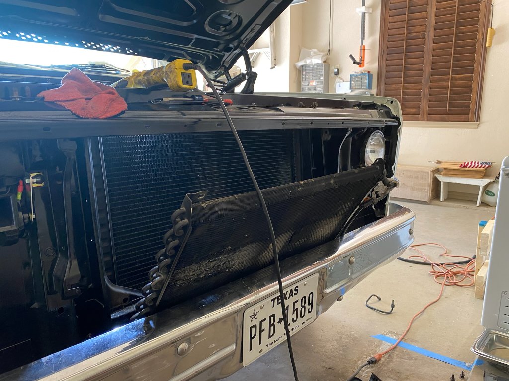

Well we have done as much as we can do until we find out if our local hot rod shop is interested in doing the VA install.. If not it will have to wait till end of the month after Easton’s church camp..
