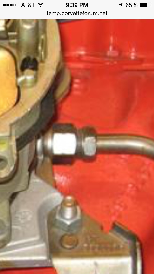

If I am not mistaken the steel line has a flare and nut and it threads into a fitting that connects to the carb via 1/4" NPT pipe thread. You may need to use two wrenches. One to hold the fitting and one for the flare nut. Unless its rusted tight it should come apart.

That's pretty much what mine looks like. I tried to turn the nut on the steel tube. The fitting in the carb didn't move, only started twisting the line.
I might have to buy the 3/8 fitting with the straight barb. Ought to work.......and it's only $3.00

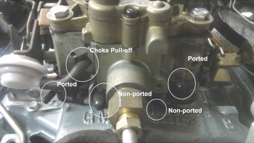

Oh, sure you could tap another line. You just need to tap into a manifold vacuum or non-ported vacuum. Dont forget your check valve.
