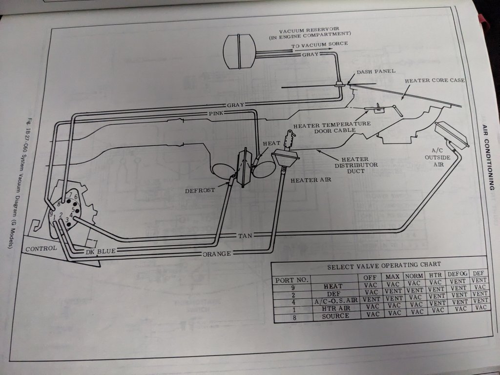

I forgot to add a vac diagram. It looks like the single line goes to the head unit, so hopefully that will help

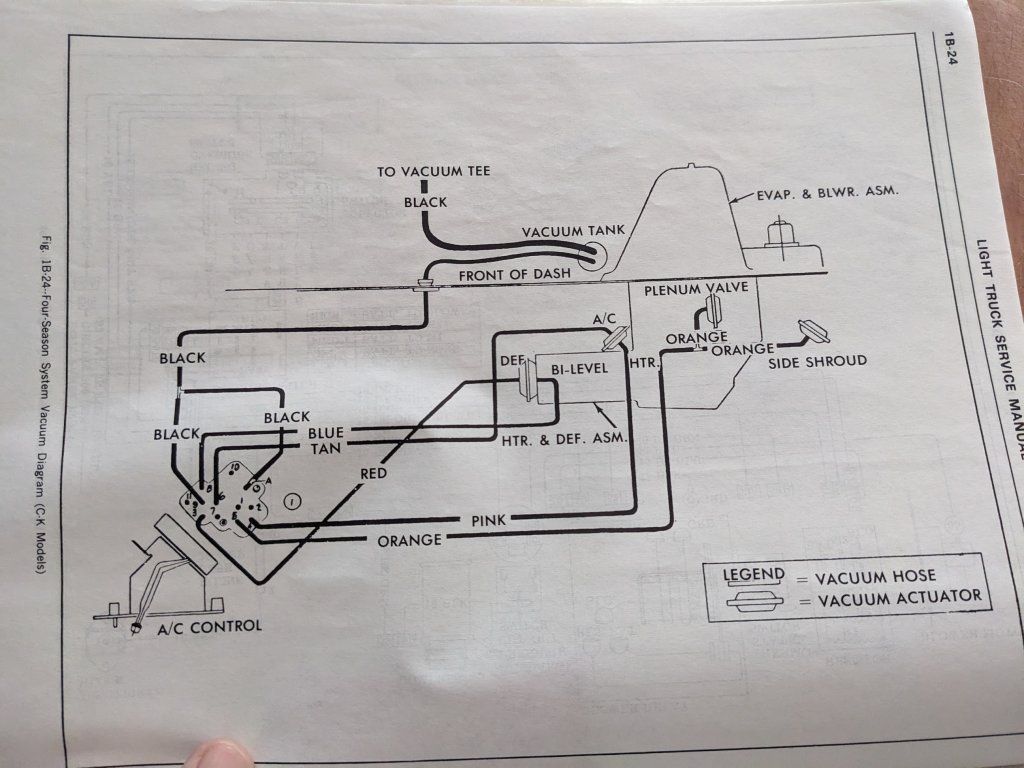

The vac routing diagram I attached earlier was for a C60 model.
Here is the correct one for the C-K10 models.

Where does this vacuum line connect to in the engine compartment?
Snoots
Jan 23, 2013
10,651
25,437
Georgia
Roger
Jimmy Sierra
350 w/203
Vacuum canister
