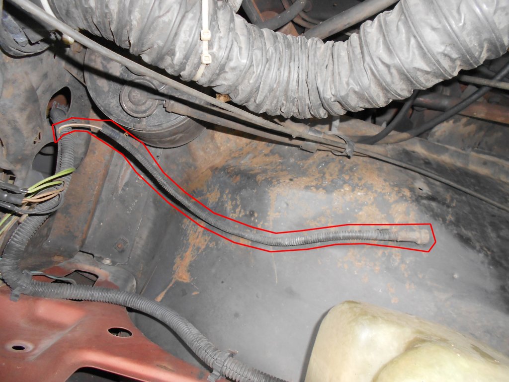

Hello, all. The wire outlined in red in the attached photo is a mystery to me. Obviously, it's loose on the driver's side of the engine bay and disconnected, but I haven't found the connection point. What does the wire control and where does it connect? My vehicle is a 1982 C10 with the 4.1-liter six-cylinder engine. Thank you.

Looks like it could be for cruise control module??

Looks to me like the brake warning light that comes from the proportioning valve under the engine on a crossmember. Looking straight down from the top of the radiator, steering gearbox is on the right:
Wiring Circuit #33 = Brake warning light

Well you can't stop there, like, where did it go? Brakes?

Well, this is interesting. Four days after I reconnected this brake-related wire, my brake warning light comes on. I haven't noticed any braking problems. What could be wrong? And what's the primary purpose of this wiring connection and valve? The emergency brake is not engaged. I've already checked that.

Check the fluid in the reservoir. Or your e-brake isn't disengaged completely
6,408
10,921
Or maybe that's why it was disconnected you could have air in rear circuit or out of adjustment and the combination valve is doing it's job. You probably wouldn't notice if rear circuit was restricted.

We all call it a proportioning valve, but as Rick stated it is a combination valve. Two separate functions, first it will put the brake light on if you have a major fluid leak, front or back.
Rust and corrosion can put the light on over time (valve fails) without any fluid loss.
The second part of the valve "proportioning" does this:

All this information is great! Thanks to all the contributors. There's no telling how long I've been driving with this wire disconnected. I checked the brake fluid about two weeks ago and everything seemed to be OK at the time. Nevertheless, I'll make an appointment for a brake inspection and get it done as soon as possible.
