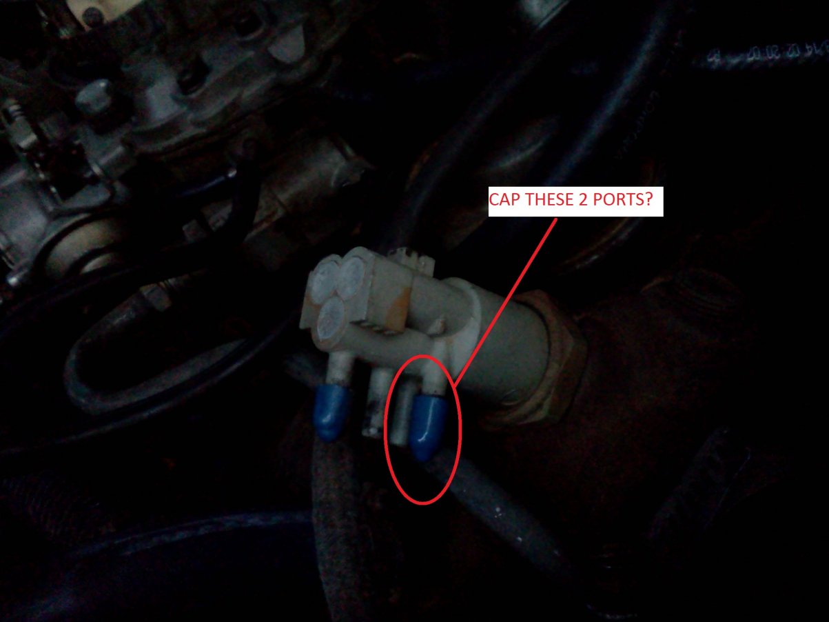

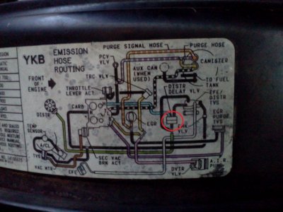

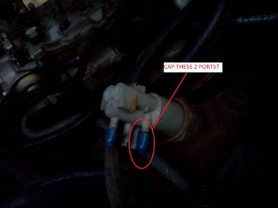

I am missing the "Distributor delay valve" shown in the vac diagram below.
My understanding is that this valve will have the vac advance running from ported vacuum until the engine gets up to temp and the thermal switch kicks it over to direct manifold vacuum.
Is this correct? Or do I have it backwards and it runs on direct until the thermal switch kicks it over to ported?
If it is running from direct vac after warm-up, I should be able to cap the two lower ports of the "EFE / Dist TVS" as shown in the vac diagram and run the vacuum advance directly from manifold vacuum without seeing any difference once the engine is up to temp, correct?
A little experimentation has shown that, with the base timing at factory spec, the 'burb runs / drives MUCH better with the advance connected to manifold vacuum than when connected to port "H"on the vac diagram.
Thanks in advance (no pun intended),
-Josh

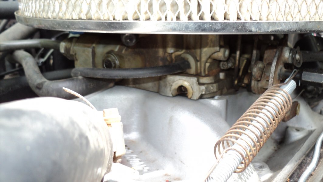

Are you still running the Q-jet?? If so, this is where the vac advance goes. (the small hose)
