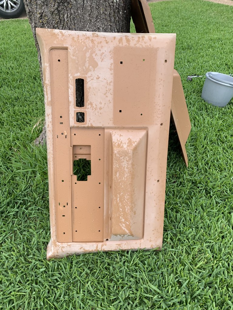

For paint itself, I used rustoleum 2x on the door panels and dash pad of my 76, had found a color that was dead nuts for the OE saddle color. It has held up very well, the door panels are looking rough again, but that’s the plastic itself is rotten. The door panels I did in 2017, the dash was 2019 when I replaced it with the one from my buddies 75 K5, ironically it was a saddle dash, painted/dyed black, then I returned it to saddle.

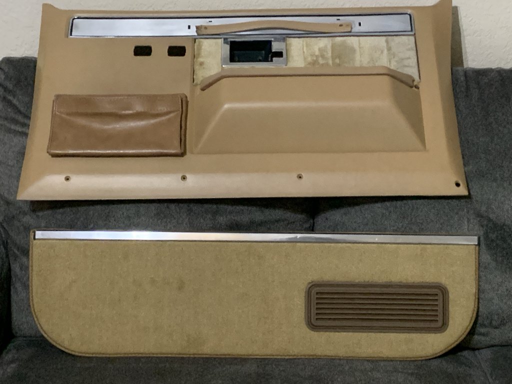

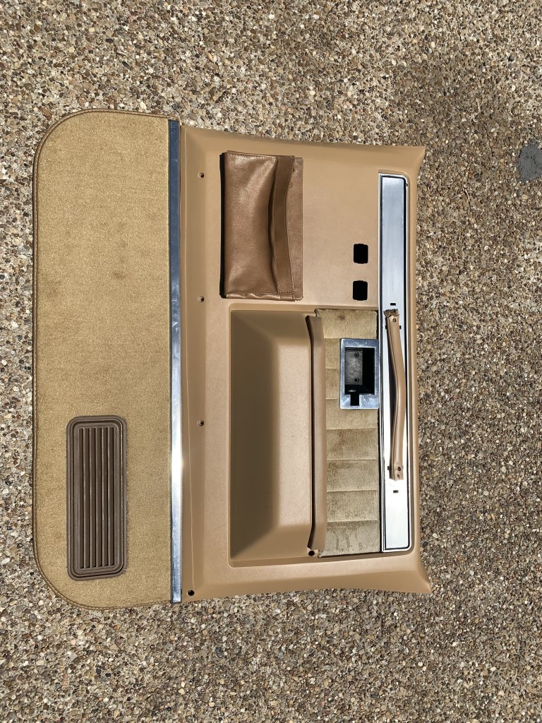

Go find Tina King on Facebook. She does seatbelts restorations for our trucks. She can explain in detail, with photos. I got my dye from USA1 because of the exact color match. And it does absolutely depend on prep. Prep 5 times before you lay down one spray! Good luck, it’s worth it.

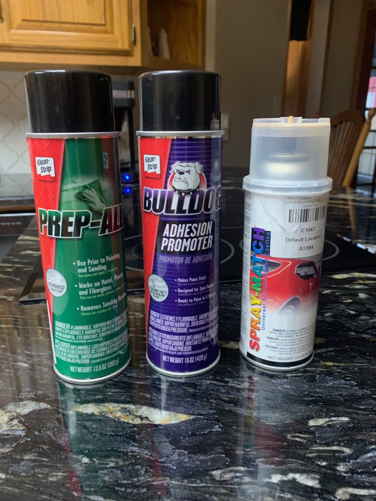

I used interior paint from USA1 along with these products, very happy with results on interior trim pieces. Clean pieces to be painted with Windex or soapy water and let dry. Use PREP-ALL as directed and let dry. Spray light coat of ADHESION PROMOTER and let dry for approx 10 minutes, then apply paint in light coats.
