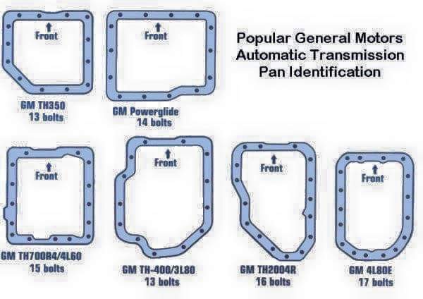

Even though the temptation to fraternize with you on the topic of alcohol preference is tempting, I'm wondering if it moves or stays still in park? If it parks like it should, I'd glance through everything to make sure you don't miss anything before having to tear it down. It should still shift to third even if the electric detent switch is messed u so I guess that leaves the governor and modulator. I'll assume with you that it's a TH400, but you'll have to look at the pan to be sure. I think it'd be an extreme coincidence that something external went wrong with it before you used park to stop it.

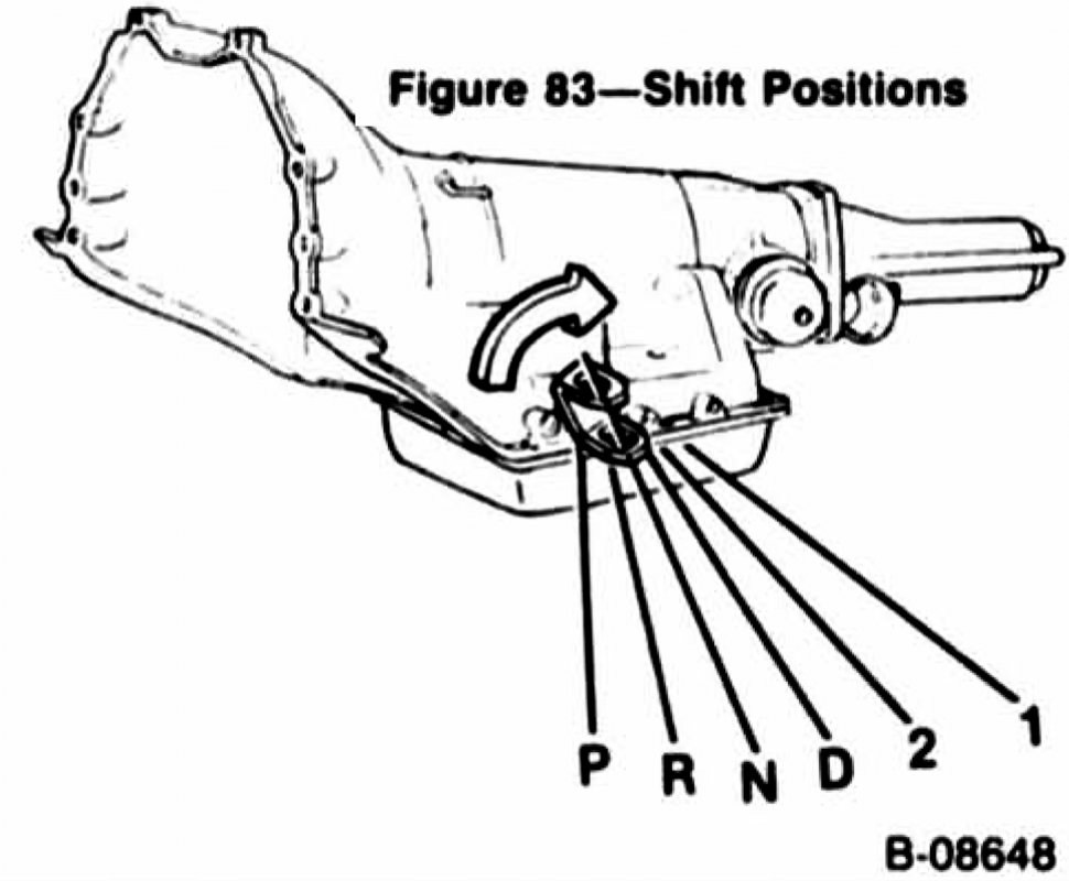

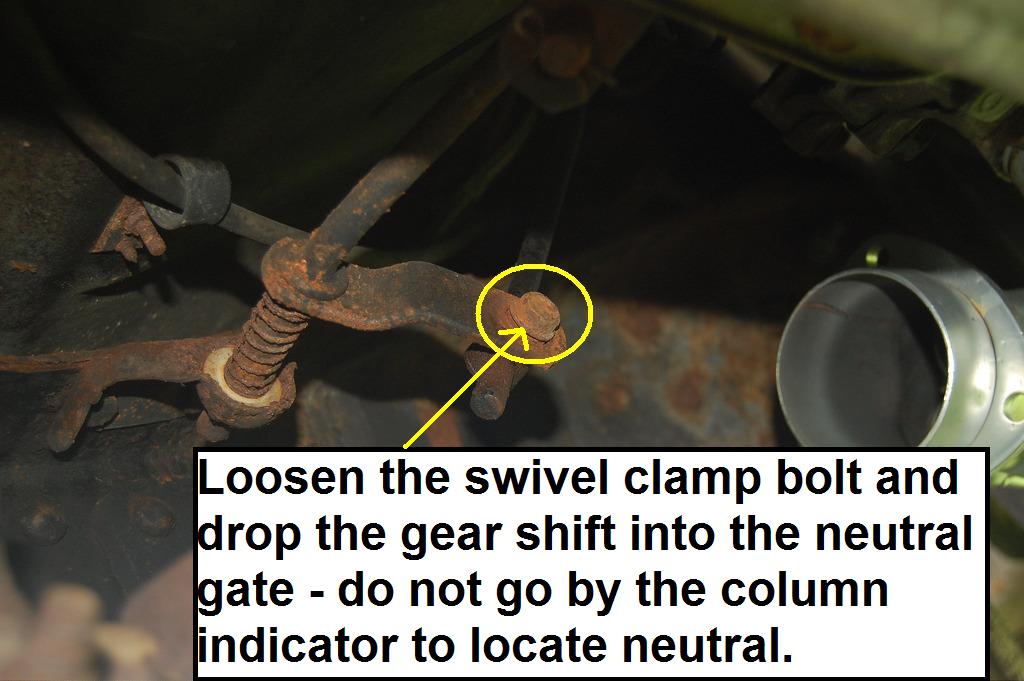

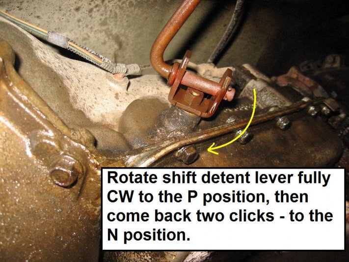

First thing I would check is that the gear shift linkage is not out of adjustment. First loosen the swivel clamping bolt at the end of the shifter rod. When the rod is free to slide in the swivel, go to the gear shifter and place it in the N position. Feel for the drop into the neutral gate, don't go by the orange indicator on the column.
Get back under and rotate the detent lever CW until it hits the P stop. Then rotating it CCW, count 2 clicks (first one into R and the next one into N).
With the detent lever in that position, tighten the swivel clamp bolt.
Start the truck, put the shifter in "D", cross your fingers and test drive.
