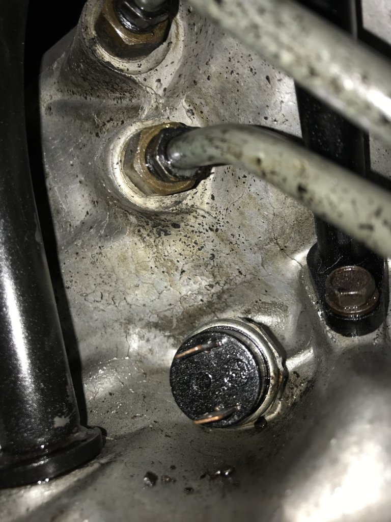

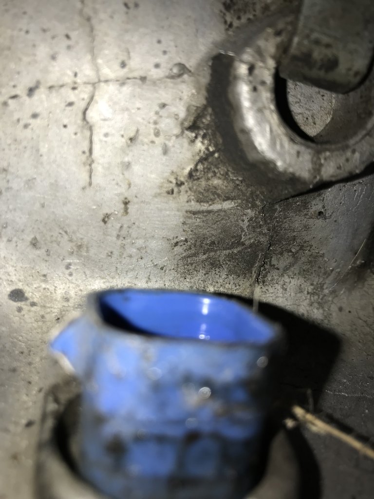

Here's the two connections on the trans. the blue one is on the left side and the black one is on the right side . I believe the black one is the tip in switch?

Yea, you no longer need the plug by the cooler lines.
Also, that's definitely a th350c
Referencing from the cconverter to the tailshaft (or right ti left in your picture) on a 700r4, the dipstick comes first, then the TV cable.
On a th350, the kickdown cable comes first, then the dipstick.
You definitely have a th350c
Please post pics of the pan so people can know what you are actually working with. Its been asked repeatedly on this thread. If you can post pics of the connectors, why not actually identifying pics of the trans itself?

and the drivers side 4-prong connector makes it a "C" version with the lockup converter.
