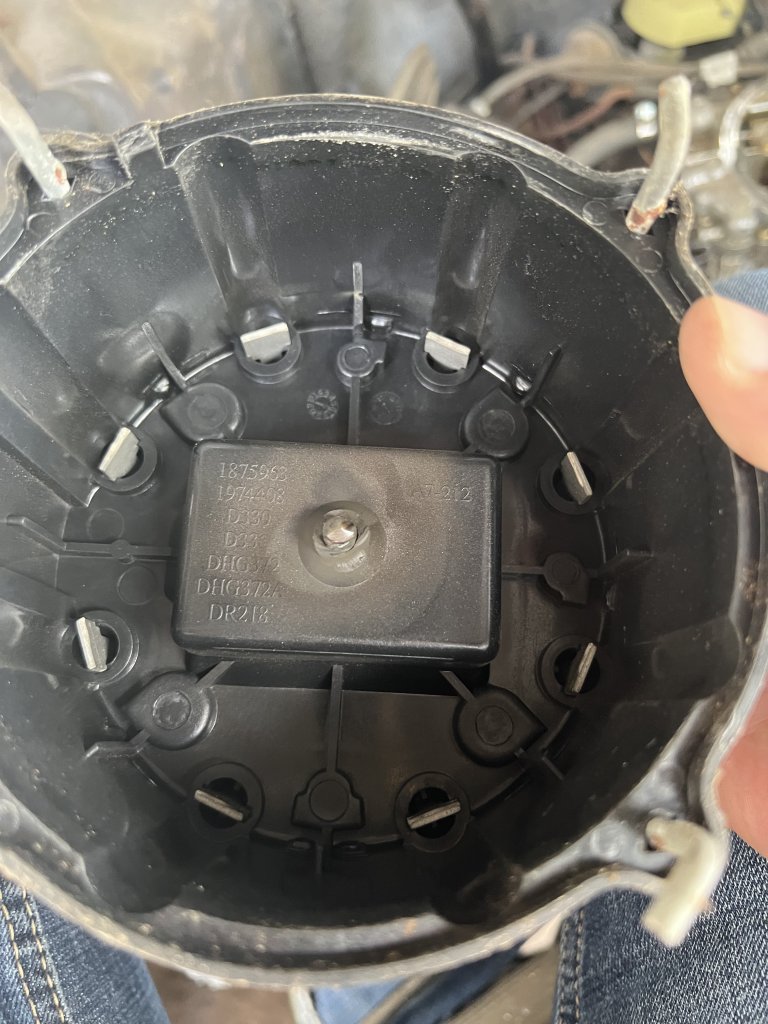

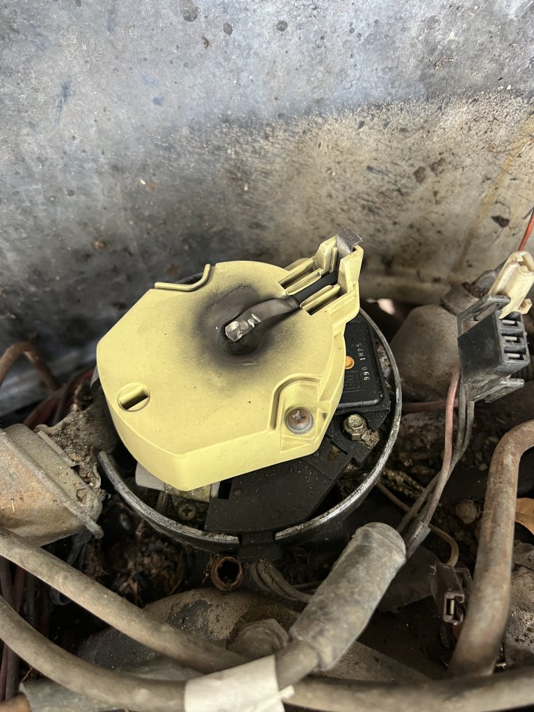

@SirRobyn0 @sidschev … I think the banging was popping into the exhaust, on passenger side, but it also has vacuum problem. PO really screwed this thing up.
These initial pics are what cap and rotor looked like when I replaced them.

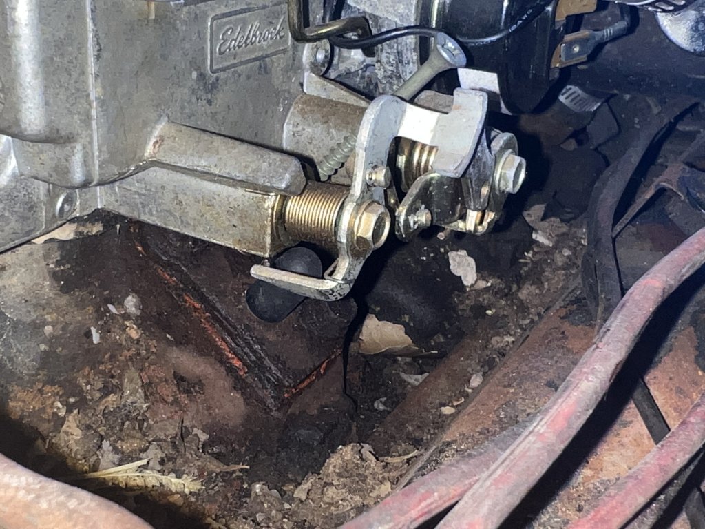

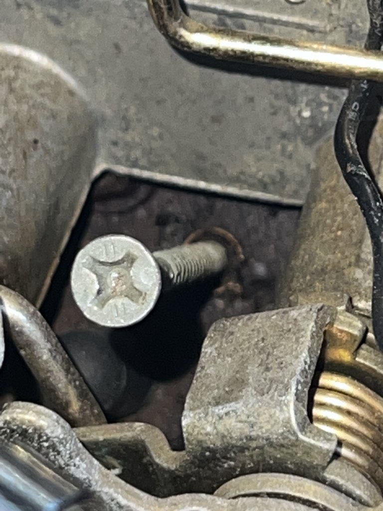

The last two pics are what I found as far as vacuum problem. I am assuming those are manifold vacuum ports? I don’t even know where they go. I put the screw in so you could see what I’m talking about. It had an old cracked cap on it and I accidentally broke it off when checking it.
I’m going to:
Plug the manifold ports.
Add 1” riser since I guess you are supposed to when going from q-jet to Edelbrock.
Check vacuum again and see what happens.

@Dano500 I'm not trying to be difficult but as I said before without being able to hear it we are all just guessing. Firing in the exhaust manifold I suppose could be described as "banging". If it came up after the tune up I still question the firing order. Obviously a bad valve could cause that as well. Lean mixture is generally back firing in the intake, but sometimes exhaust. IDK if any of that is really helpful, but I still suggest recording the noise if you can.
