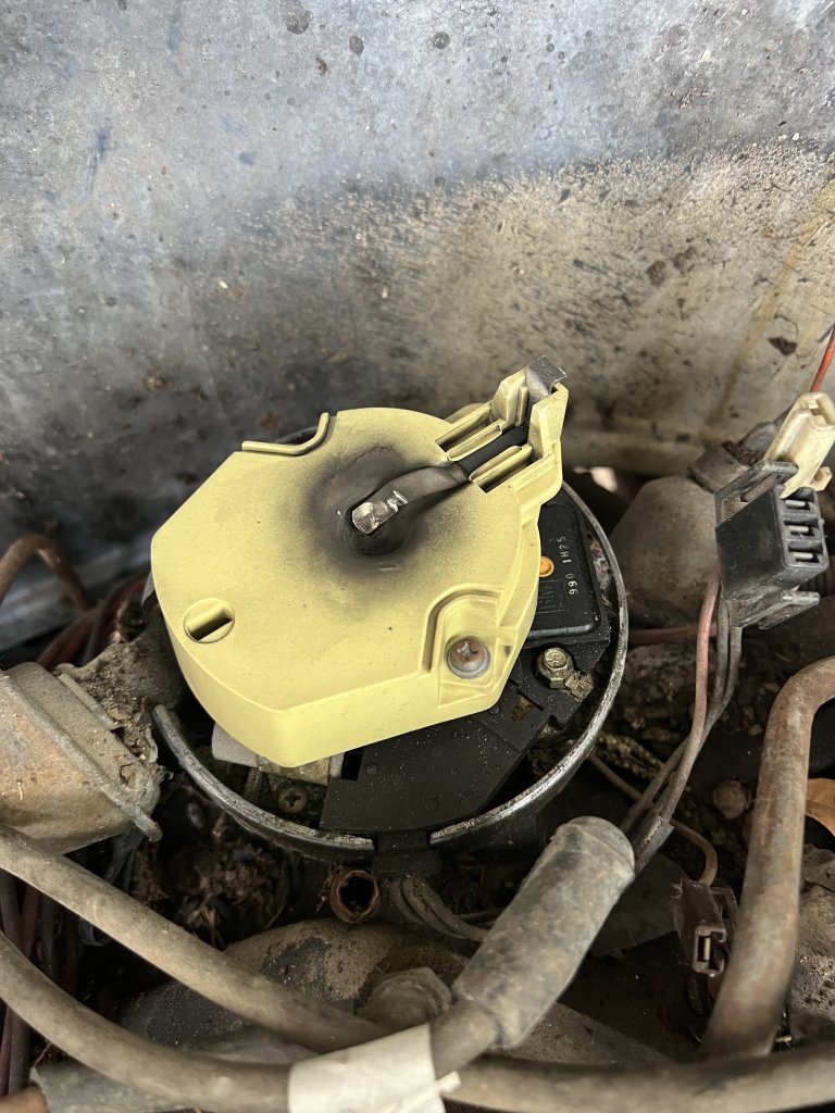

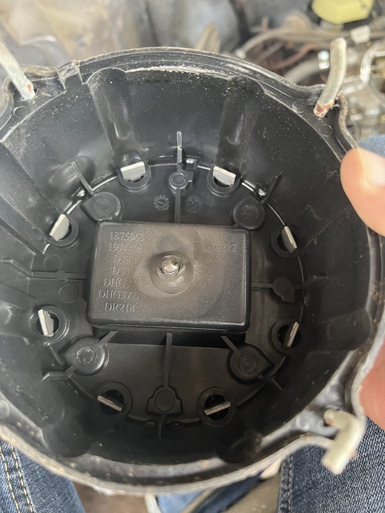

So, has not been driven hardly at all since I bought it. I finally did enough to get it on the road, in regard to minor stuff like steering box, suspension stuff.
So, I went and got it inspected and noticed that it just feels so sluggish with acceleration, of course maybe that’s what 175hp feels like, IDK. Drove fine, but always had a blown muffler, so I’d hear a popping sound from time to time coming from the back. I replaced the rotor, cap, coil, plugs and wires. Immediately noticed it idles much higher, but now there is this weird “banging sound.”
After tune up, I turned it on, noticed higher idle, but that’s it. Got it, put it in reverse and as I backed up, noticed the sound. Wasn’t with any cadence like lifter tap. I thought something was touching driveshaft, or fan? Maybe I left something somehow. Nope. Couldn’t find anything.
When I turned it on a few days later to explore it some more, I heard it in park. I did noticed an exhaust manifold leak on driver side this time around. It’s not a tic like with lifters. When I heard it from the cab, it literally sounded like something clashing with moving metal. Idk I haven’t don’t any other work on engine besides tune up.
Any ideas? Thanks in advance

@sidschev @squaredeal91, thanks, I’ll check firing order. I drove it around the neighborhood just before the tune up and no banging, so maybe firing order vs. tq converter bolts.
Thank you both.
