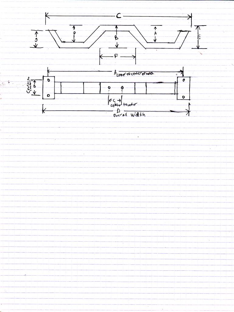

To make it easy on us I will make a drawing of the cross member and label all the measurements that I will need.
There are a few different ways i can go about making it, Either using Square tubing (which is how I made mine), or I could make it out of channell iron.
BOTH will be as strong if not stronger then the OEM. and Both will be a direct fit.
I will draw it out real quick.

Ok heres a CRUDE drawing of it.
attachment.php
The sooner you can get the measurements the better. If I can get the measurements by tommorow I can get it built sunday.

It shouldnt, BUT it would be nice to see a picture of yours especially where it is bent. I could probably take the measurements off of my 85 BUT mine is a 1 ton frame and not sure if that would effect it.
