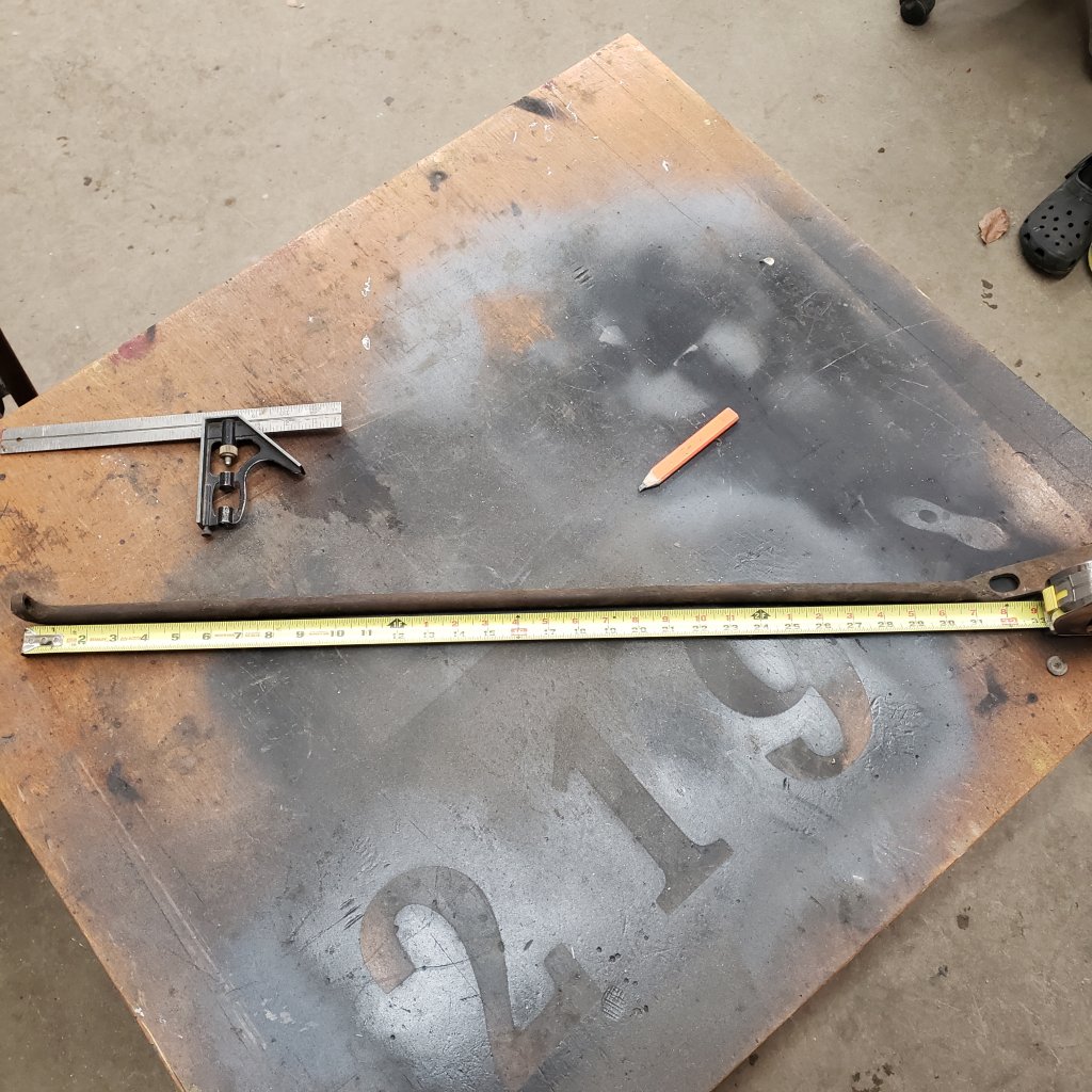

I got lucky the guy I bought my 208 from just had the brace laying there with it.. there was no mention of it in his ad.
It’s 36 1/2” works good with the TH400 and an aftermarket adapter.
Fabbing one certainly wouldn’t be difficult, mild steel would be adequate.
