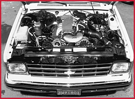

Some TPI porn I found....
C-10:
CJ-8:
Studebaker:
Volvo S70:
31' Ford Coupe:
