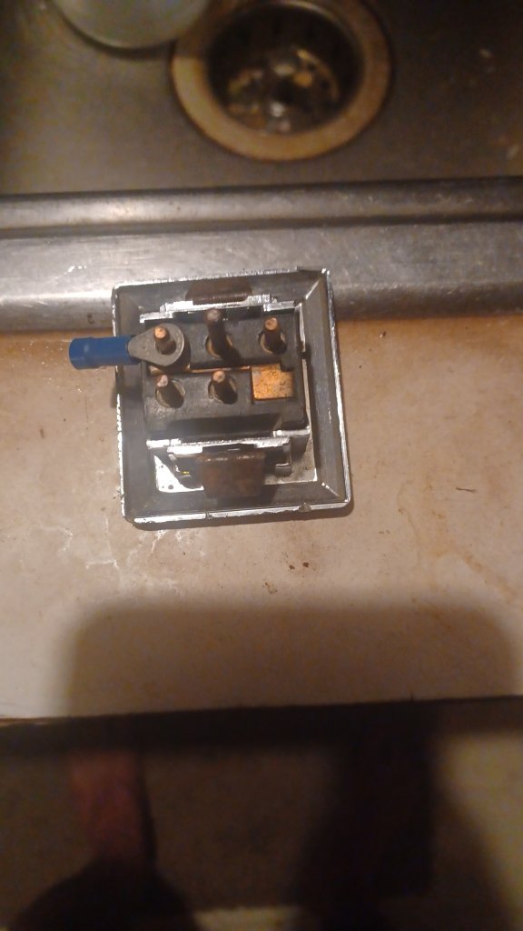

So....wire broke off for my driver window switch. Where can I find these crimps? I don't even know what to call it? All of my searches turn up every kinda crimp but this one. Can they even be purchased? Or do I need to try to spread it and reuse it? Thanks in advance

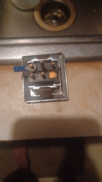

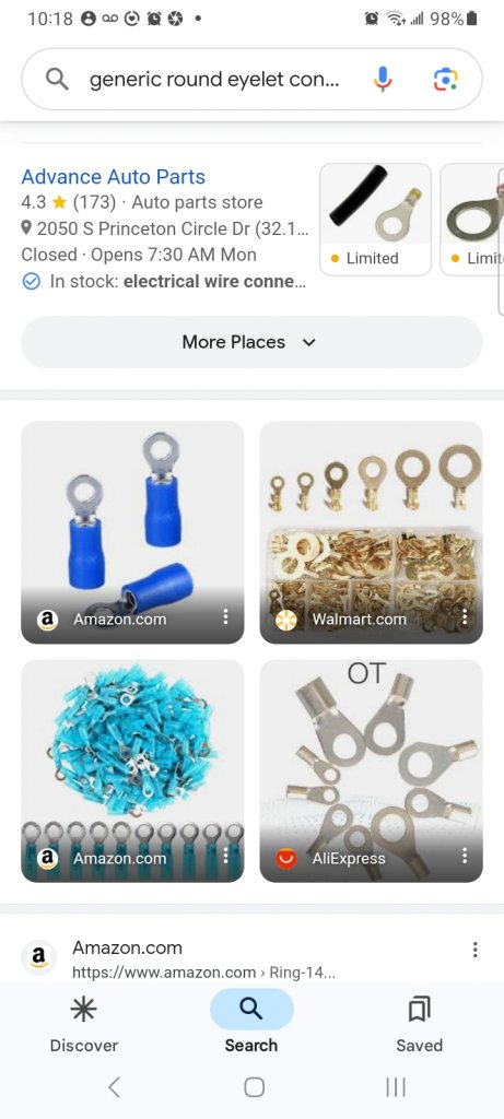

On my 86 when I took off the drivers door panel I found a round eyelet connector crimped on a broken wire,then the P.O. put it over the appropriate post on the switch and pushed the plastic block connector into place which trapped the ring connector. I never would have known it was done,if I hadnt seen it. I put it back the same way. I went and grabbed an old switch and a ring connector to show youc,put it together like this and push the factory connector back in place. I took a pi c for you.
