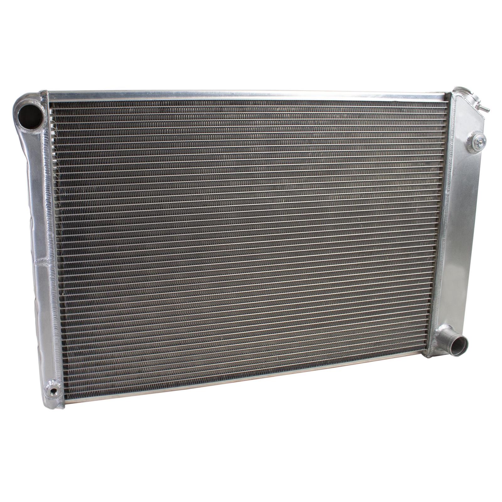

ended up going a Cold Case "77-87 GM truck 21 Inch 1.25/1.5 Outlets Cold Case Radiator" was quite pricey but i think it'll pay off. Got it off of High Five Motorsports, sold it a little cheaper. Never got an email of shipment or anything. Contacted them and said it had a lead production time of mid to late April. So that kinda sucks. Then i got the new Brothers flier and they now advertise aluminum radiators for Squares. Go figure. But at the same time, i doubt they had them at 21 inch and i'd probably be waiting twice as long for them.
When i swap it out, i'll fill you guys in on how it goes and take some pictures.
