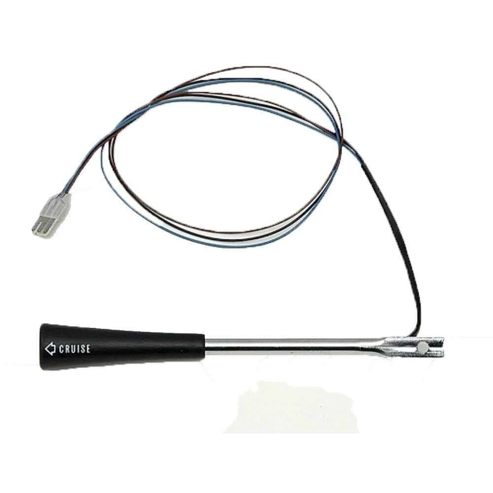

ok so im tracing wiring from the original lock up harness. what a nightmare! so D went to the old EGR solenoid. A went straight into the firewall. B splits into 3 wires,to old EGR solenoid, to vacuum sensor, and to firewall. The 2nd wire for the vacuum sensor goes to the firewall also. So all three wires go into the cab, green from tranny A, Blue from B/EGR/Vacuum, and blue with black strip from vacuum. Sold blue goes inside the cab then goes to the brake switch the runs also the cruise control. Green and Bluew/Black go to what looks like a relay or controller on the base of the steering wheel. WTF haha
