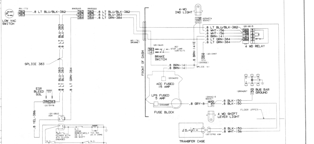

There is three wires going to the TCC lockup in the 700r4. Yellow goes to an egr bleed valve. You can bypass that, most people just cut it when they bypass the spark control. Green is a test circuit. You may have a green wire by the fuse box with an orange end. If you give it 12v in 4th gear the TCC should lock up. This will let you know if the trans is working/not working or if it is a wiring issue. The blue wire does the work. It leaves the fuse box as a brown wire with 12v ignition power, then hits the brake switch and provides 12v out of the blue wire when the brake peddle is up then onto to the vacuum switch near the brake booster, then to the trans. There is also a blue with a black stripe wire out of the vacuum switch. This goes to the 4x4 circuit to bypass the TCC lockup in 4 wheel drive.
Test it at 45-55mph as stated above. You really don’t even need a tach, it is obvious when the rpm’s jump by 500. If nothing happens, start with the brake switch. They go bad often. Look for 12v on the brown wire at the fuse box and the switch, then make sure the blue wire has 12v when the peddle is up and so-on down the circuit until you get to the transmission connector.

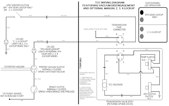

All 700r4s can be run with no ecm and lockup can be made to work. Post a wiring diaghram for the year and vehicle the transmission came from and I can tell you how to wire it. Some required a ground and a hot lead Some the tcc solenoid is grounded in the transmission. If the tcc solenoid doesn't require an external ground then run 12v through a normally closed brake switch through the firewall vacuum switch,to terminal A on the transmission.
Edit, Someone else's was typing while I was and seems they know exactly which lockup solenoid you have so have a great night.
Edit. See the schematic for this car. I'd run 12v through a vaccum switch and a brake switch to terminal #A. I'd jumper terminal #D to terminal #B the 4th gear switch grounds internally. So power would go through A through the lockup solenoid out D through B and ground with the 4th gear switch.

hey everyone, more tcc lock up questions i have been trying to get my tcc lock up working as it should, i have a 86 k5, i replaced the tranny years ago with a rebuilt one out of a 88,apparently they control the lock up differently because my 86 doesn't have an ecm and the 88 does. power runs thru the brake switch and the pressure switch mounted on the firewall and then down to the tranny, i recently replaced the flex plate and torque converter, i thought there might be an issue with my torque converter and that was why my lock up was not working, turns out when i dropped the pan i found out the wiring harness was never plugged in inside the tranny, after i replaced the flex plate and torque converter it would blow the fuse as soon as it went into od, it thought maybe i had an issue with the solenoid so i replaced the solenoid and the wiring harness inside the tranny and the plug, still blew fuse, so i did some digging and realized they are wired differently between 86 and 88, i used the attached wiring diagram to re-wire it going to the tranny. B is not used, A takes 12volt straight to the solenoid, and D is grounded, so now the lock up definitely works but it is locking up in all gears, if i disconnect D then i get no lock up in any gear at any speed, looking at the diagram it shows D as a manual lock up for 2, 3 and 4th gears and disconnected it should only lock up in 4th, i used the stock pressure switches that were in the tranny, the only difference i can think of is the diagram shows 2 terminals on the 4th gear switch and the stock one only has on terminal, i assumed it was grounded thru the casing to close the switch, i did not wire in a on off switch or any of the leds shown in the diagram, i figured unhooking D would be the same and im not really looking to have lock up in all gears just in od, am i missing something or do i need to replace the 4th gear switch with one with 2 terminals? any help/advice would be appreciated,
