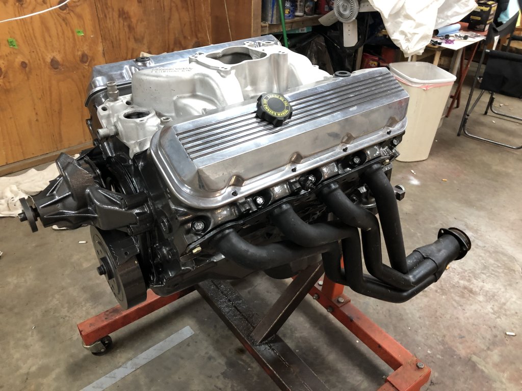

The 454 rebuild Speed Pro 10.22:1 domes Comp 268 hydraulic flat tappet / Comp lifters Comp timing set Comp springs Melling oil pump Cleveite bearings self ported heads Edelbrock 2.0 intake 750 Holley vacuum secondary etc…

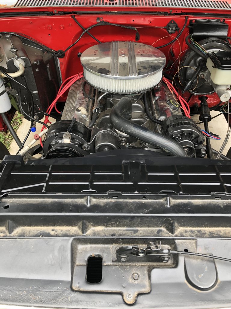

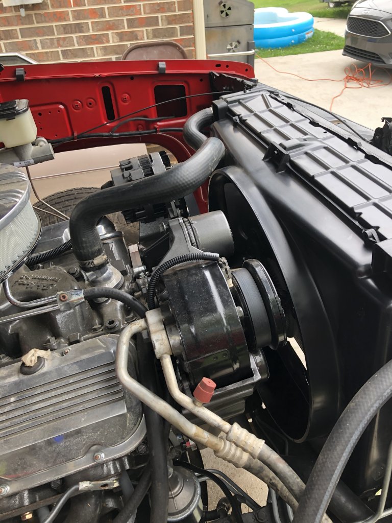

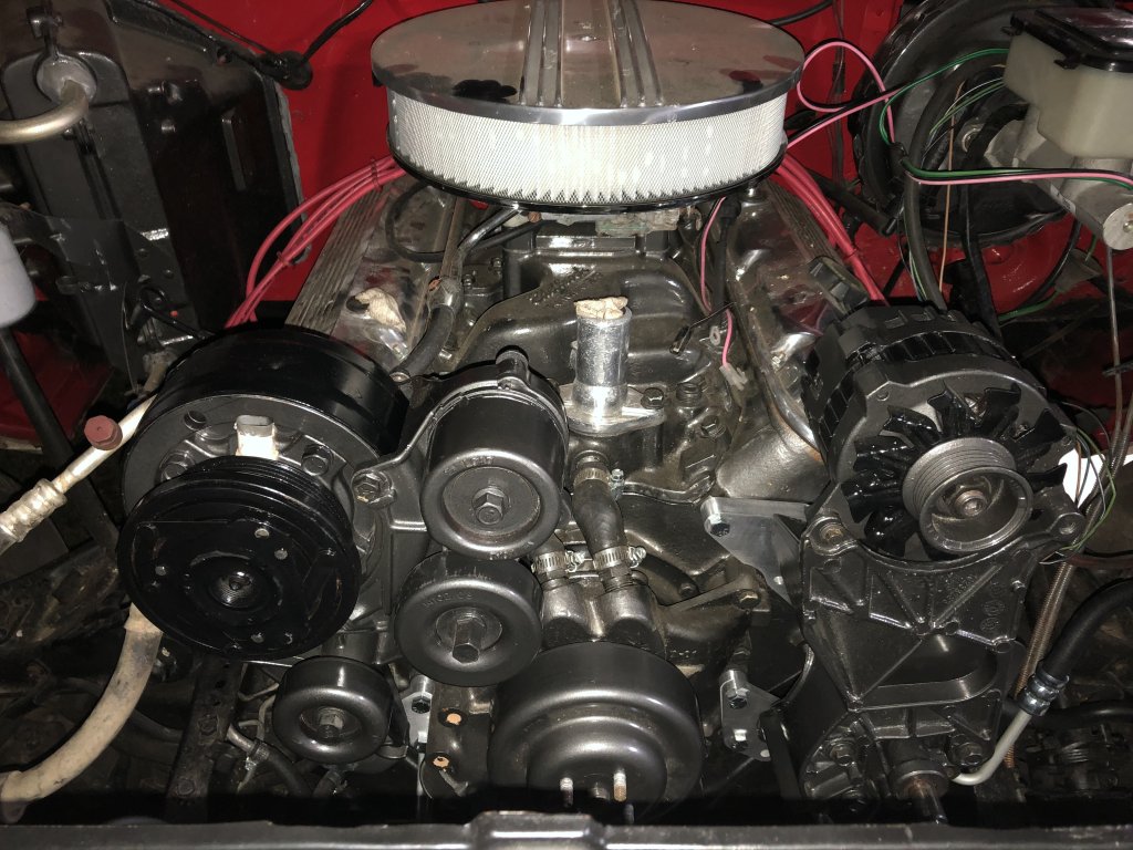

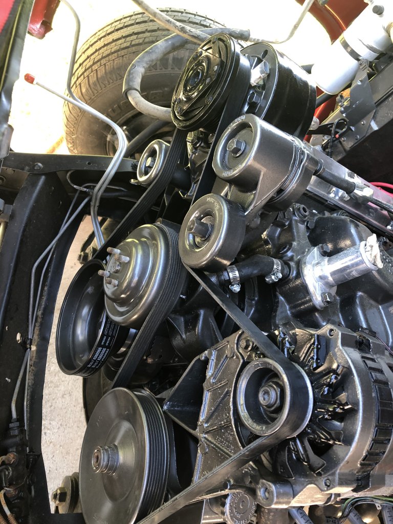

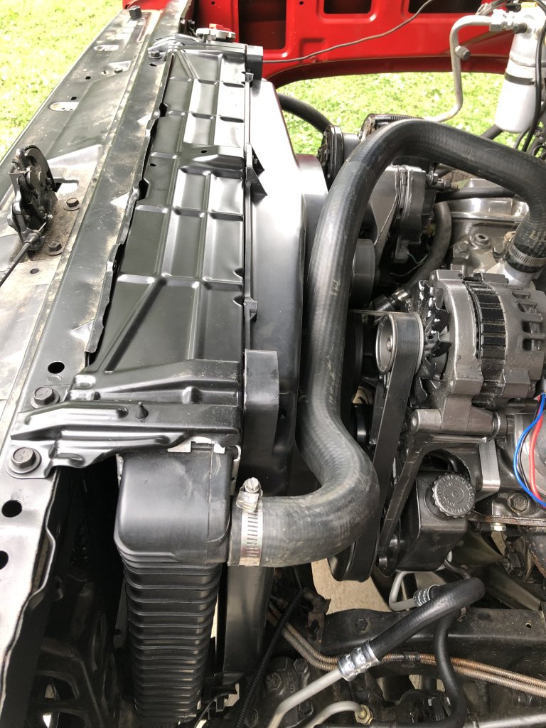

Small block serpentine kit adapted , complete new cooling reverse flow water pump,rad, hoses,belt ,shroud fan clutch,heater core etc… New brake booster and master cylinder, cleaned and painted frame, inside fenders ,inside and outside of core support etc…

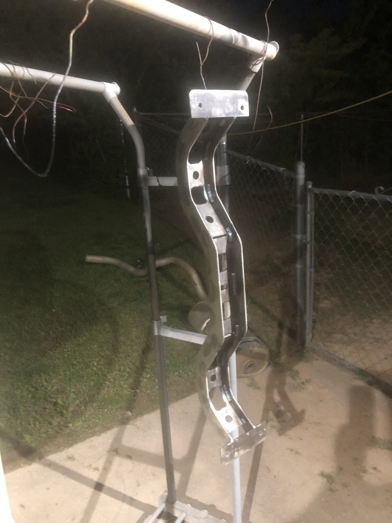

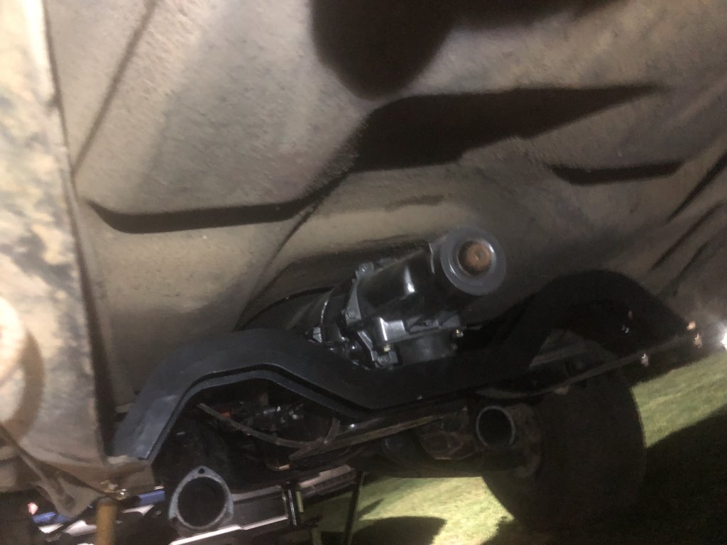

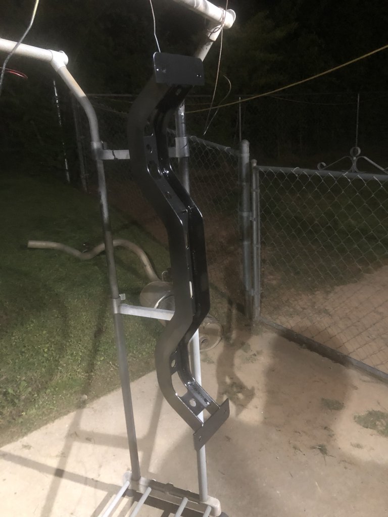

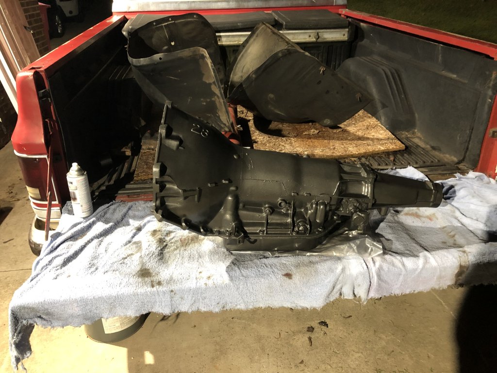

Painted the rebuilt transmission, new torque converter, line’s double hump crossmember shortened drive shaft with new u-joints

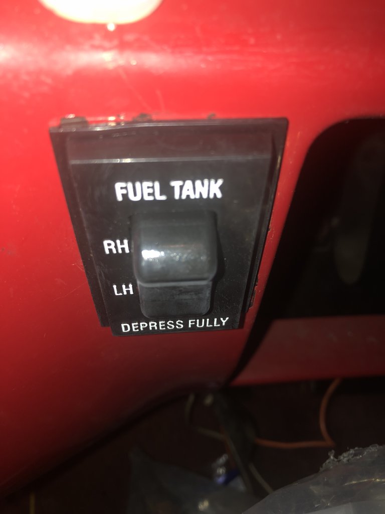

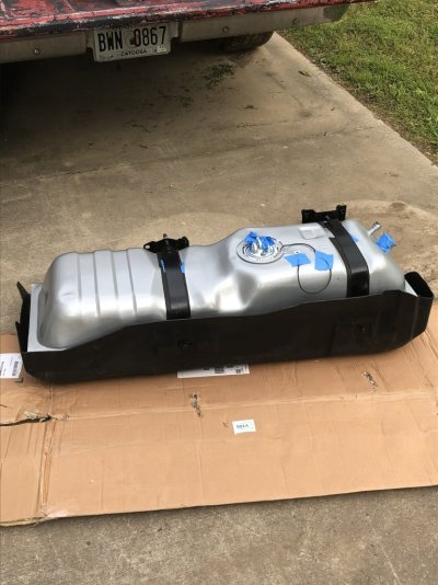

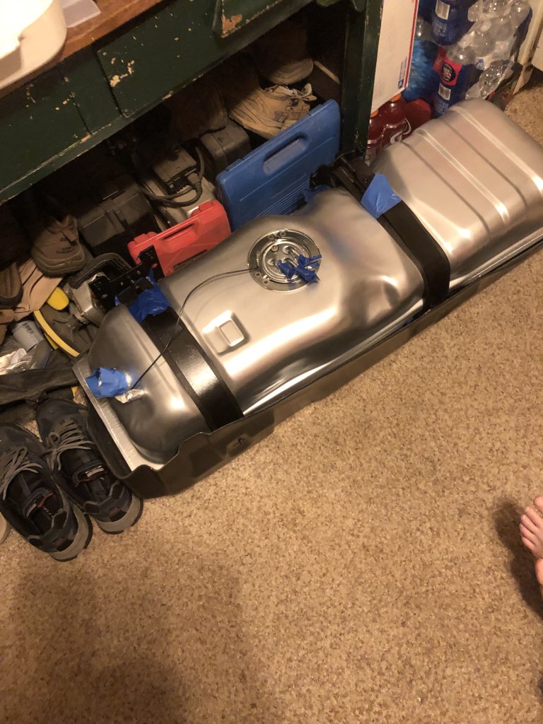

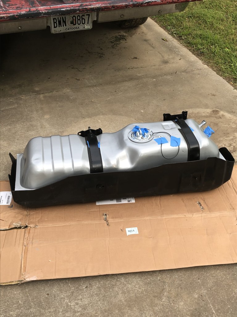

Everything for the fuel system was replaced minus the hardlines. Both tanks, sending units, filler necks,caps, selector valve, hoses, clamps, fuel pump,selector switch, had to repair the harness and added additional fuel filters between tanks and selector valve.

Looking really good. Reminds me to replace all the 41 year old rubber sections in the fuel system.
Did you stay with hard lines for oil and transmission coolers? Braided stainless brake lines? Rubber or silicone radiator-heater-vacuum lines?
