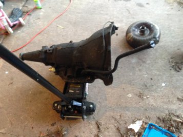

A friend of mine actually made me a cool little set up for the jack. Its a square plate for the pan to rest on with a piece of pipe welded to the center of the plate to sit in the jack. You take the regular cup out of the floor jack and the plate just fits right on there. It was actually a great idea and worked GREAT! Ill get a pic soon.
