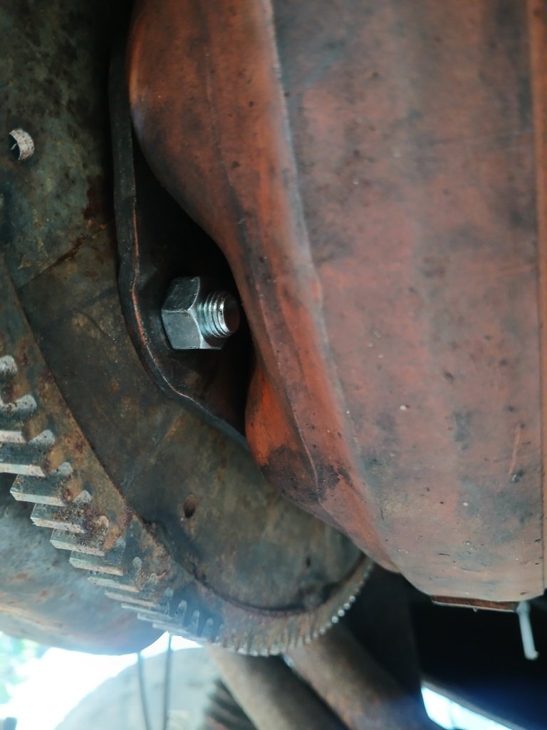

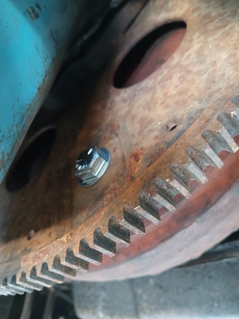

Got em! First test around the yard was successful!

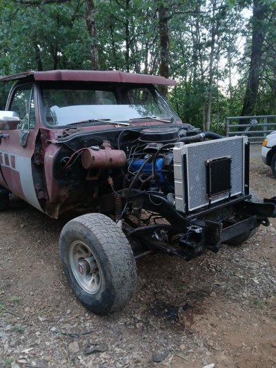

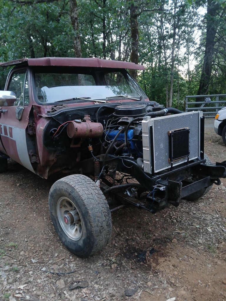

Ha! Sweet ride. I would bolt that hood down right where its at, put some bull horns where the front bumper would be, and rock it like that on the road. Maybe get a personalized plate that says "MadMax".

I was actually seriously gonna mount it to my roof like a visor lol. I'll trade it out with a worse one. I think it looks cool for a tuff truck.
