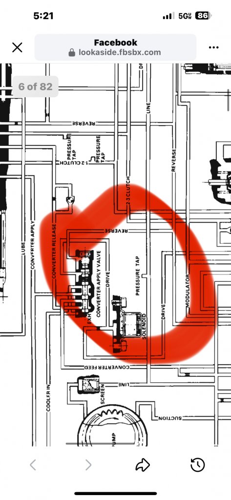

Here is a hydraulic schematic from a service manual.
As you can see, line pressure comes out of the pump, and tee into the pressure test port. It then continues to the manual valve. The test port is dead headed at the pipe plug.
Adding potential issues, I remember someone here trying to use the pressure tap for a temp gauge, and finding out after installation the shifter wouldn’t move. The temp gauge bottomed out in the case, the broken pieces of the sending unit fell down into the manual valve and locked it up solid.
Lastly, the case is the last place you want to use to monitor temp. It will be the slowest to warm, and slow to cool down. You want to monitor the fluid temp, not the case temp.

Yes, it is a dead end flow path but unless that dead end path is crazy long before it tees into the circuit, there's going to be fluid going past and circulating the fluid in the test port passage.
I've never used a temp sender in the test port of a th350, but I have in a 700r4. In that case (no pun intended, lol) it worked perfectly fine and had no issues at all with the gauge displaying rapidly changing temperatures. It was obvious that it was reading fluid temperature and not case temperature.
