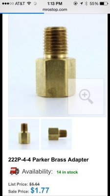

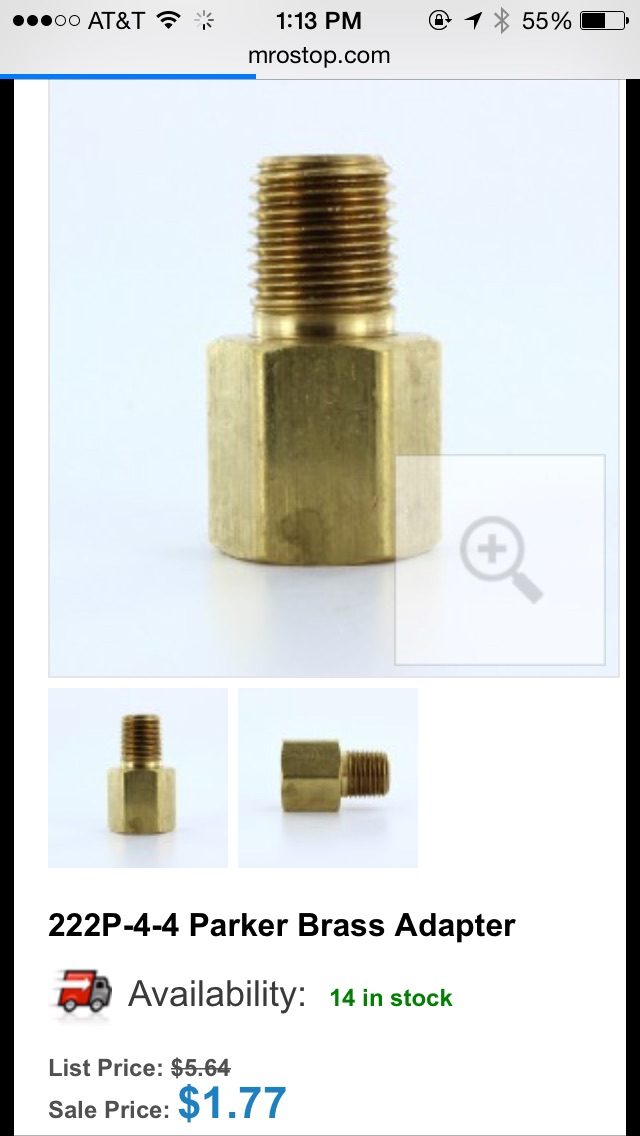

What about using a brass 3/8" male NPT to 1/2" female NPT adapter so you can just thread in the older unit with the correct resistance parameters? The male side should thread in flush with the head and the end of the sender will be making contact with the surface of the head so I don't imagine much differentiation from the actual temperature.
1987 GMC Jimmy
Automobile Hoarder
Jan 23, 2016
5,848
2,387
Mississippi
Jesse
V1500 Jimmy
Hmm, maybe not. I didn't even think about the sensor portion not being threaded. The adapter probably won't be deep enough to thread it in there good.
