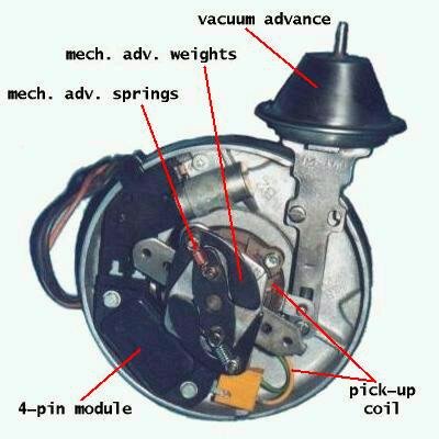

yep, while cranking, no spark at plugs. i used a breaker bar to turn crankshaft pulley and get no. 1 cylinder up closest to head. the rotor was pointing in that direction of the no. 1 when the distributor finally sat flush. at first i wired directly to the battery but no spark at all. Then i found the 12v ignition wire (that went to TBI coil) and then the loud back fire occured. since then no spark at all. PRIOR to ripping off the TBI unit, intake and distributor i could spray starter fluid and it would fire right up. doubt its the timing chain or dizzy gear, timing is correct. where is this icm located? if you got a diagram of what to look for that would be helpful.

ICM is in/on the distributor as "4-pin module."

ok then i pulled that sucker out and took it to autozone to get tested and it passed all tests on the machine. So that not an issue. Possibly no power to the factory 10 gauge pink ign wire at crank mode? What to do next :gr_guns:....
EDIT: ahh i didnt notice this black ignition switch, maybe this it.:Insane:
