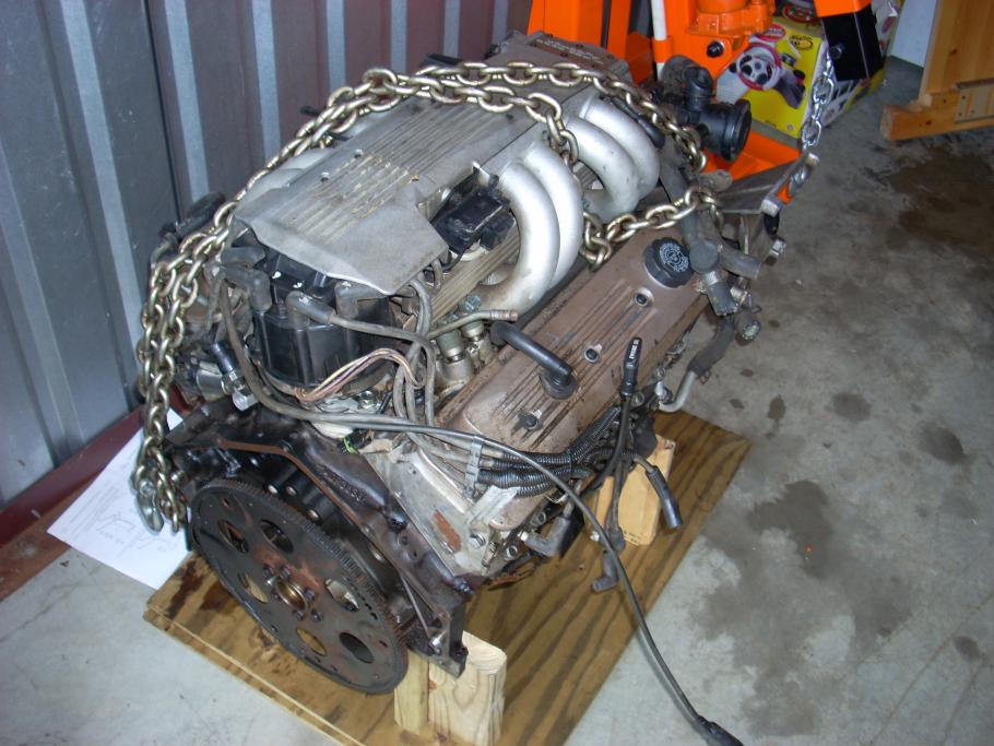

You have any pics of your TPI....Post em up...Make this a real EFI Post!

You have any pics of your TPI....Post em up...Make this a real EFI Post!Hers my old one:(

Only pictures are of it not in the truck. Couldn't get the bugs worked out on the dyno before I went back to work so am currently running the same engine on a carb. And yes, all I did was change the intakes. I have people ask all the time if it still has the EFI cam in it.
