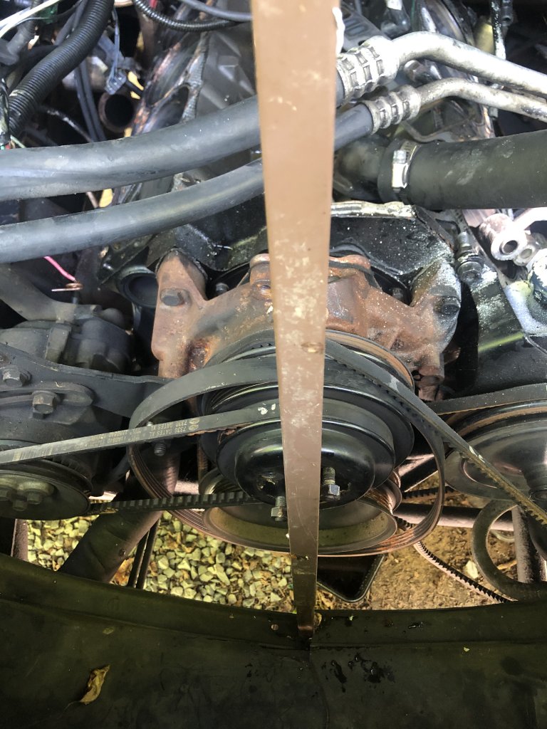

Preciate it boss

When untightening flywhhell from torque converter the engine fan rotated counter clockwise. Thanks

Seems when I’m trying to undo the bolt the flywheel turns wether I have the breaker bar in or not ?
