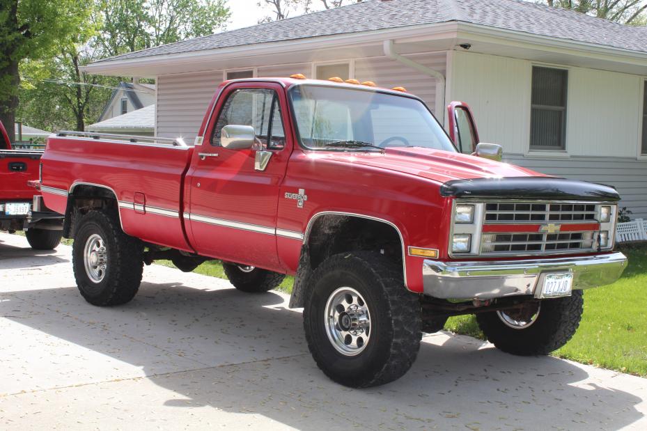

What do you think my 6.2 is worth ? The truck only has 82,000 original miles on it.

Burner to a gasser.. Im'a go cry now :p
Ugh I'd hate to see that beautiful burner get swapped to a gasser (just a personal thing :p .) Honestly, I have a tendency to offend people when I make offers.. I can tell you what a crate 6.2 will cost, but that's a hard comparison lol. Though, if the price is right.. you'll find me on your doorstep (ill make the trip for a J-burner)..
I will tell you this: If you decide the 454 is going to be too much hassle, and you want more Umph out of that 6.2, find a 3.8l supercharged Pontiac. The supercharger is a damn near direct fit to the 6.2 J's intake (need to weld up a bracket, replace the Air intake resonator bracket with it).. adds avg. 20# boost.. noticeable difference.
Good luck on either route you take.. gorgeous truck btw
