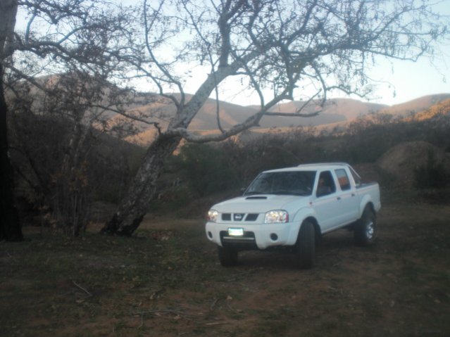

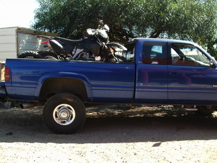

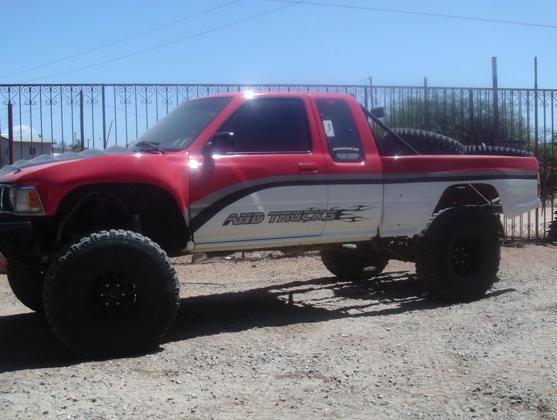

Thanks for both of your comments. As far what are my goals for this truck. Im a retired guy,have a home in So Cal. Also Baja/ mex man cave,have so much fun dirt biking/4 wheeling. I now stay here most of the time.I already have Dodge diesel 4x4/jeep/Nissan 4x4 turbo diesel/ Toy off road truck 28in travel/4x4 bronco. So why did I buy this 82 chevy 4x4.Nut case I have always wanted one,this truck no rust,perfect paint. I got it for 2800. I have total now in it just 3 grand. I removed front sway bar,also it had bolt on Over load springs mounted on top of rear Susp. Removed those also,all this did help ride. Also I do know leaf (and agree with you) never will a leaf front end.Be like a spring front end.As I stated already My Toy has Deavers in the rear,it rides like a dream. As far as what do I want this truck for. Not ever hauling anything ,just driving off road having fun. As far as removing factory overload,right or wrong. I removed it from my Dodge/and Nissan when I lifted them. The Dodge has towed 40ft house trailers it a 96 to date no problem.I started to add up what I need to do to this good looking truck.The 700r has to go/the axle gears are 3.07 or close,AC/heater not working/widow regulators/ front seat/susp And more. Even the 350 is gutless. So I got a buddy 50 miles from here that has a 84 suburban 4x4 6in lift/3/4 ton 4.11 gears/turbo 400 trans/create 300Hp/Ac/heater everything works/nice big 8lug wheels/new off road 35s. I could get this truck for 2,000 to 2,500.Seats/dash everything like new.It would be cheaper to buy it/put everything that fits on my pick up.I know the rear springs wont fit. Then buy better Susp. So Im thinking try to sell my truck for 3 grand to get my money back.Or buy the Burb and make myself lots of trouble. Here is some pictures of some of the junk I already have. :shrug:
