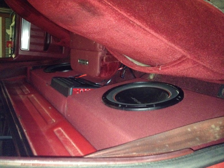

I bought a cheap pioneer setup with 2 12s and fit them behind the seat. I built a box to fit the space and they sound pretty good. I would like to go back with shallow subs soon because I did lose 1 click on my seat and I need that click! It's not horrible but I'd like to have the extra leg room.
