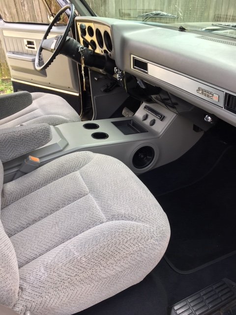

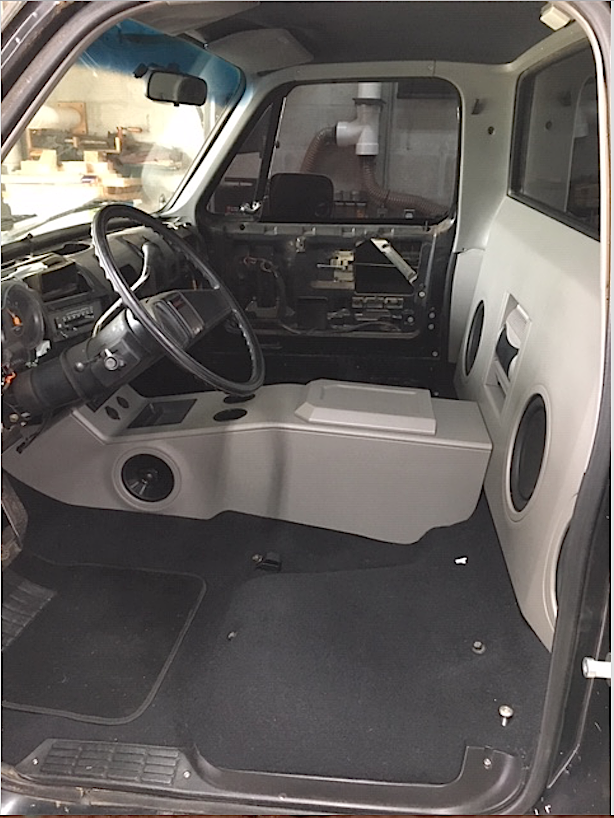

Def not much room in these things with a bench. I went buckets/console and used a Sundown 8", built the box to fit inside the bottom of the console and have it downfiring. It'll overpower my exhaust and that's no easy feat! :rofl:

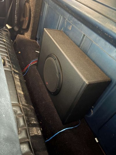

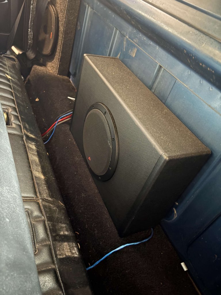

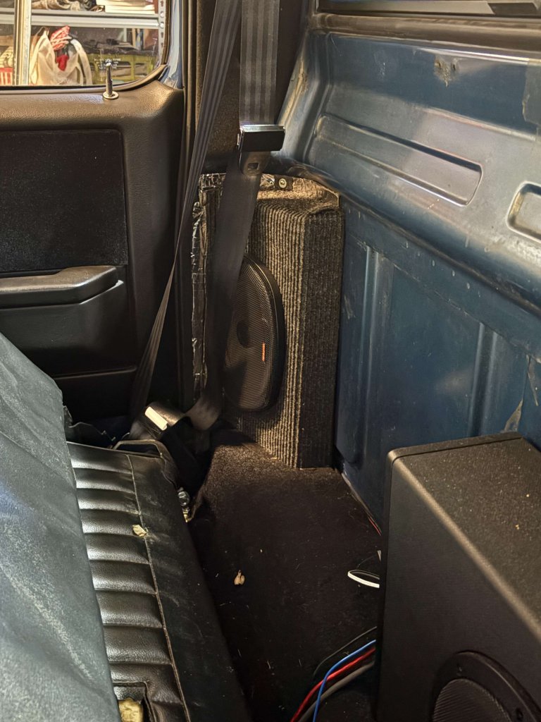

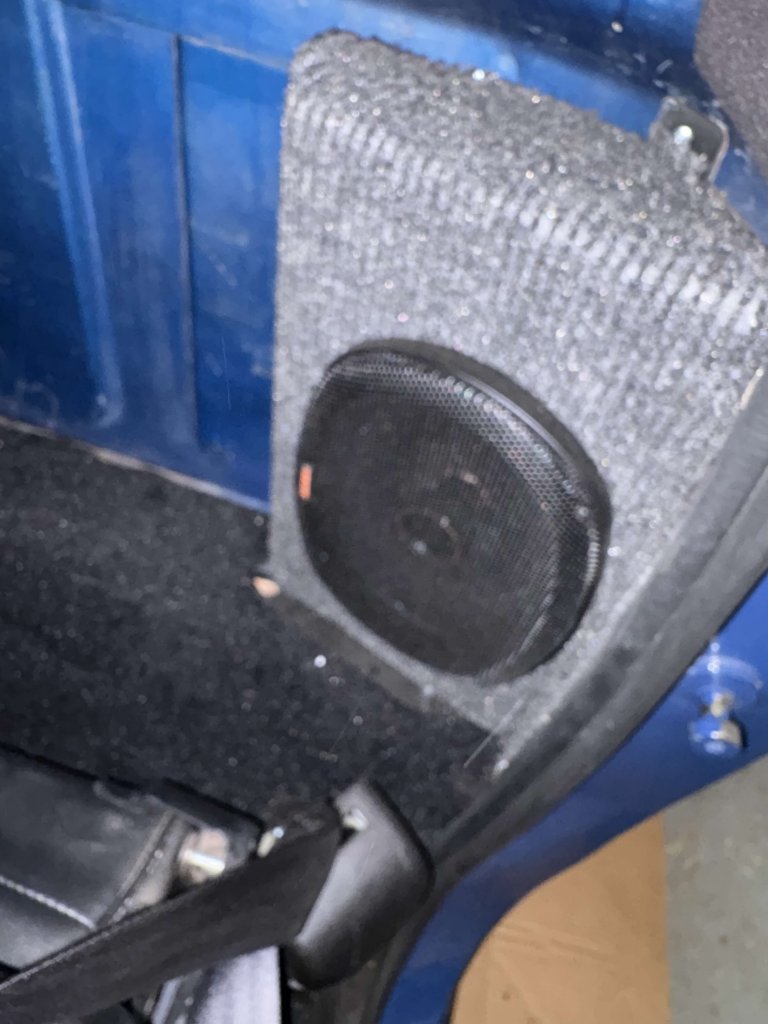

I installed an amp under the seat with these speakers that I got from Crutchfield. I bought the rear boxes online, but they were metal so I covered them with carpet and the insides with sound mat before installing. The front speakers wouldn't fit well in the door panels so I used the speaker rings to have them sit out a little bit. Not too intrusive. But when it was done, I was disappointed in the bass performance. I wish I had gotten an amp that would have powered a sub, but now that it was all installed I ended up getting a powered sub from Crutchfield. It fit great, and it sound terrific. '81 stepside C-10.

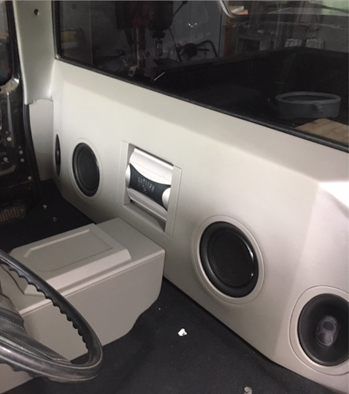

Kicker loaded enclosure with passive radiator fits well behind the seat. Paired with kicker amp. Doesn’t take up too much room in a single cab.

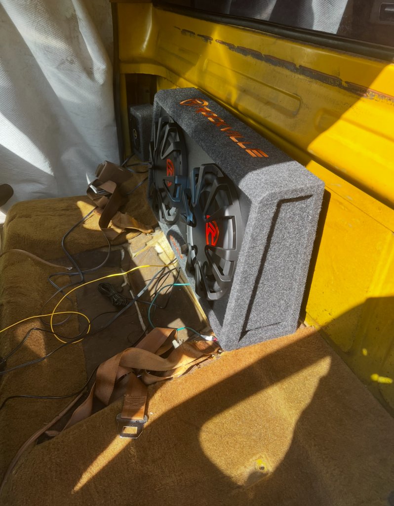

Took the easy way - Bought a thin mount Rockville sub - fit behind the seat - jams
Rockville subwoofer enclosure with 2000 watts peak, dual 12-inch drivers, and slim, vented design for deep, impactful bass. You don't want to miss it!
