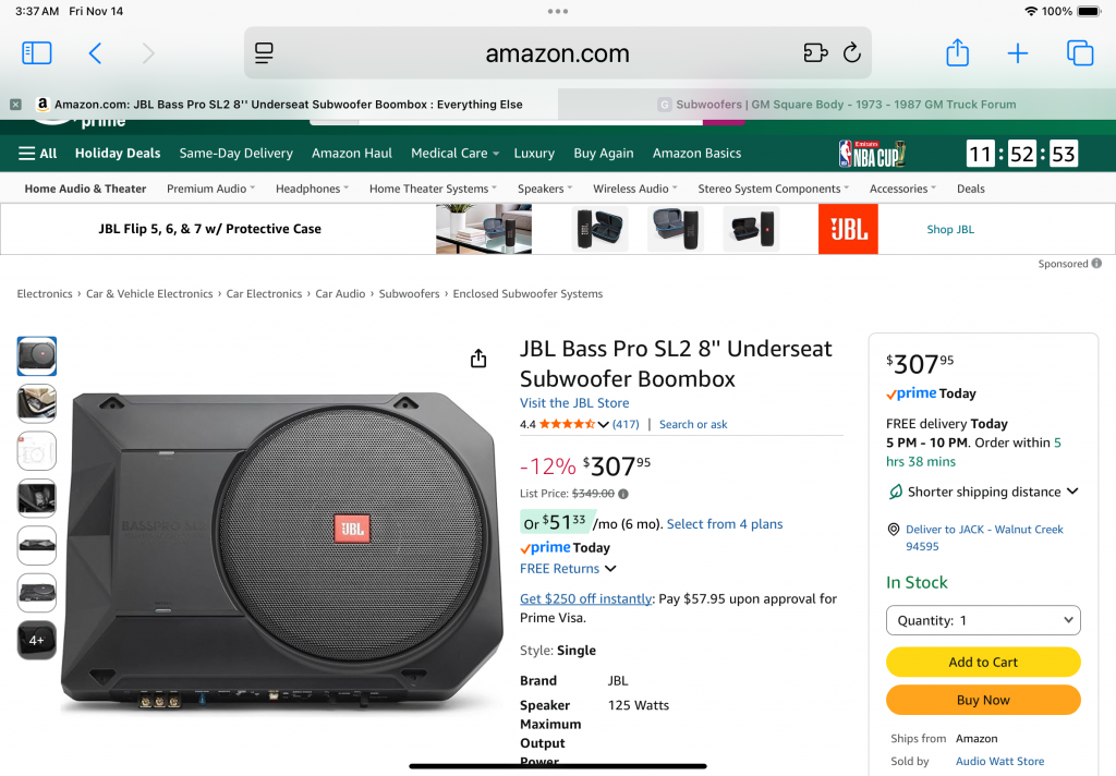

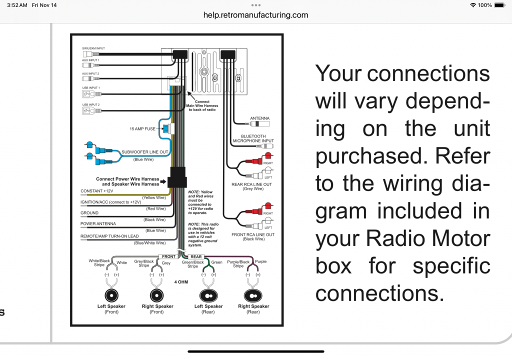

I have a JBL 8” Subwoofer located under the passenger seat, absolutely love it! I am utilizing the factory dash and corner speakers with the subwoofer.
Everything is plug and play with the Retrosound head and Crutchfield OE wire adapter. The JBL doesn’t draw a lot of amps so I piggybacked onto the cigarette lighter. Not a boom box by any means, however delivers a rich full sound.

I thought about waiting for the new kicker hs12 coming out at the beginning of this year and just getting one or two of those and putting one on each side. I have a retro sound radio with the sub options but I really don’t want to take up to much space or rattle the windows

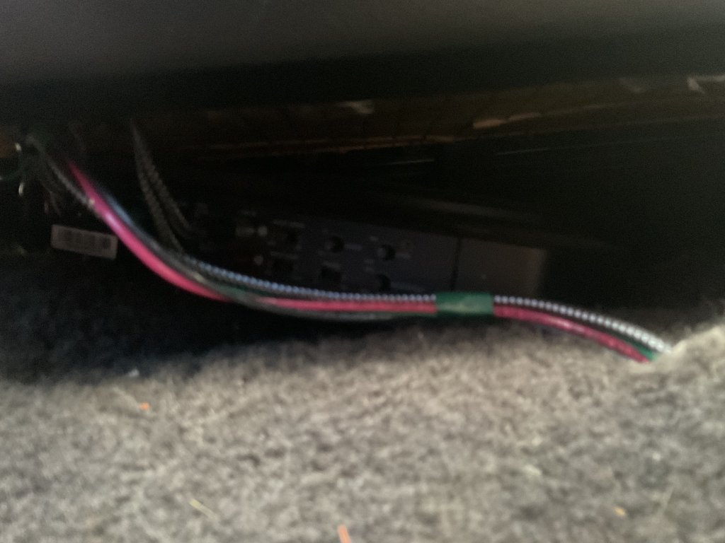

Def not much room in these things with a bench. I went buckets/console and used a Sundown 8", built the box to fit inside the bottom of the console and have it downfiring. It'll overpower my exhaust and that's no easy feat! :rofl:
Also talking about amp/power, I've got a 900W Skar Audio 5-channel, their low end version. Cheap amp, great power and sound though, I've been very impressed. Also has the option for a bass knob. Would be a good budget option even with a behind the seat box if you wanted to amp everything

Thanks for all the help. I think I will get the new kicker hideaway 12 for
Under the seat at the beginning of the year. Also need some thought on what the bass boost should be on the retro sound radio. It goes up to +7 but I have it on +2 with kicker 4x10 speakers behind the seat and the 3x3 speakers in the dash corners. I just got them and really don’t want to blow them. Thanks again
