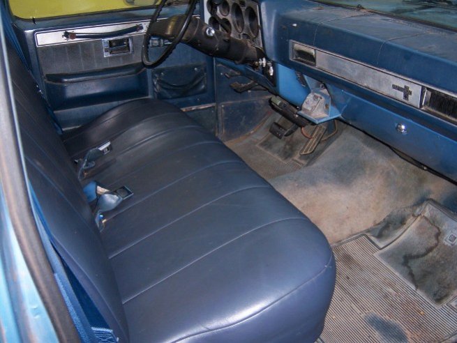

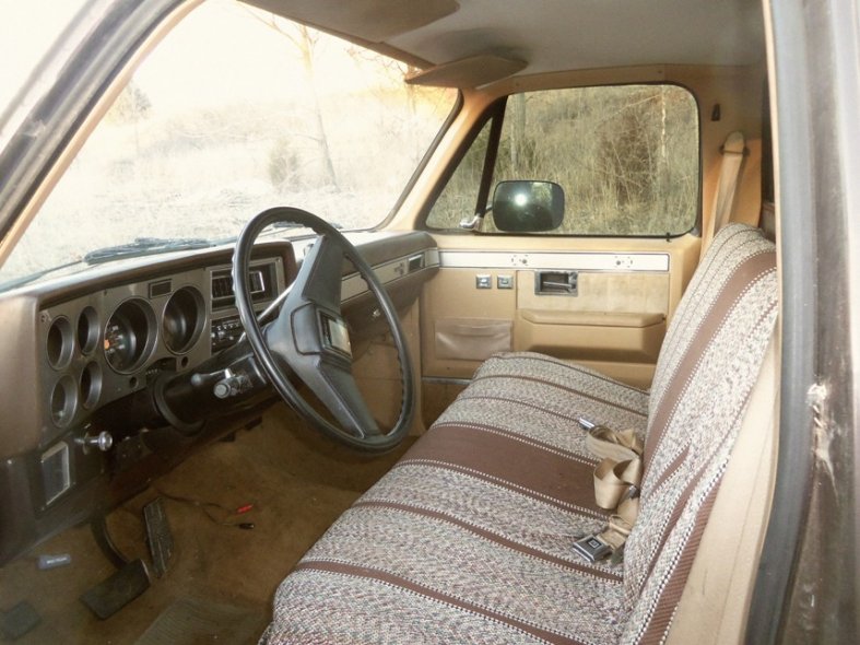

Yes, the 81-87 cabs are very different. There are low humps in the 2wd Auto cabs, hi humps in the manual trans cabs, and long high humps in the 4x4 cabs. It would prolly make your 4x4 Burb unsaleable, but most who do conversions, cut the hump out of a 4x4. I'll be doing a cab swap soon and going to have to cut the hump out of the 4x4 cab and transfer it to the new 2wd cab.
Here are pics of my 86 20 and 85 K10.

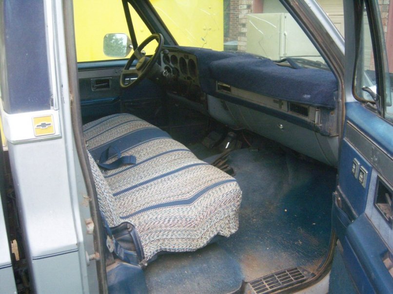

That is what I'll have to do. I am going to be recabbing that Blue 85 Diesel 4x4 cab with this 85 Gas 2x4 cab that's in much better sheet metal shape, and much better interior shape, so I'll be cutting the hump outta the blue interior and putting it in the tan interior. And I'll hope to be getting a black rubber mat instead of carpet. That tan carpet won't fit after I get the 4x4 hump in it.
