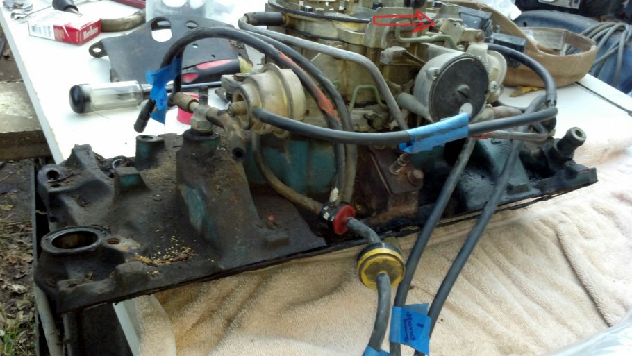

What is the adjustment screw for on the top of the choke housing? The one where the red arrow is pointing in the attached pic.

You are correct. Inside the housing there should be an arm that attaches to the center shaft with a screw. The choke element end should go over this arm and then it would open and close the choke flap with engine heating. I am including a picture.
The red arrow points to the primary choke pull off adjustment. It just adjust the positioning. You shouldn't need to mess with that.
