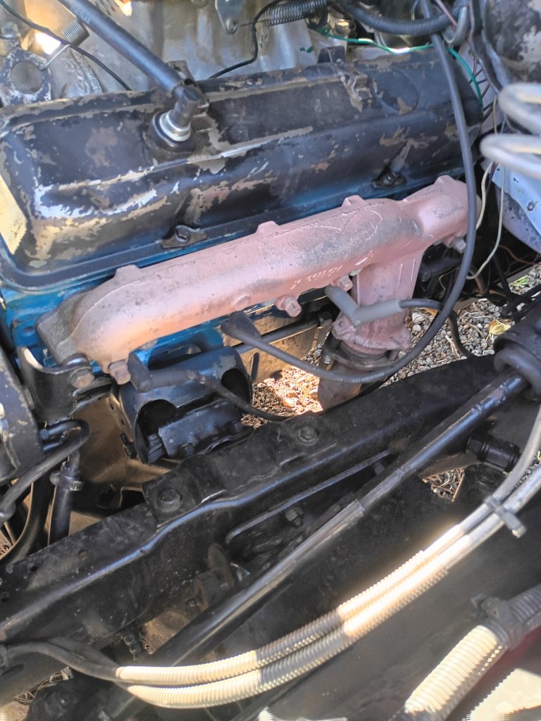

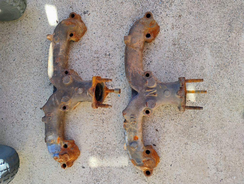

I have a set of factory ram horns off of a mid 70's GMC C8000 with a 350 that I am going to have installed on my 350. I need to go to them as my dipstick went from the right side of the engine to the left side, and with the stock manifold going "over" the spark plugs, I can't put in a dipstick. I'm also going to see about a set of spark plug wire retainers. First pic is the ram horns I have, and the 2nd pic is the stock manifold from 84
