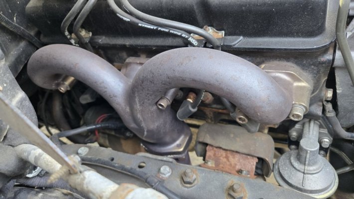

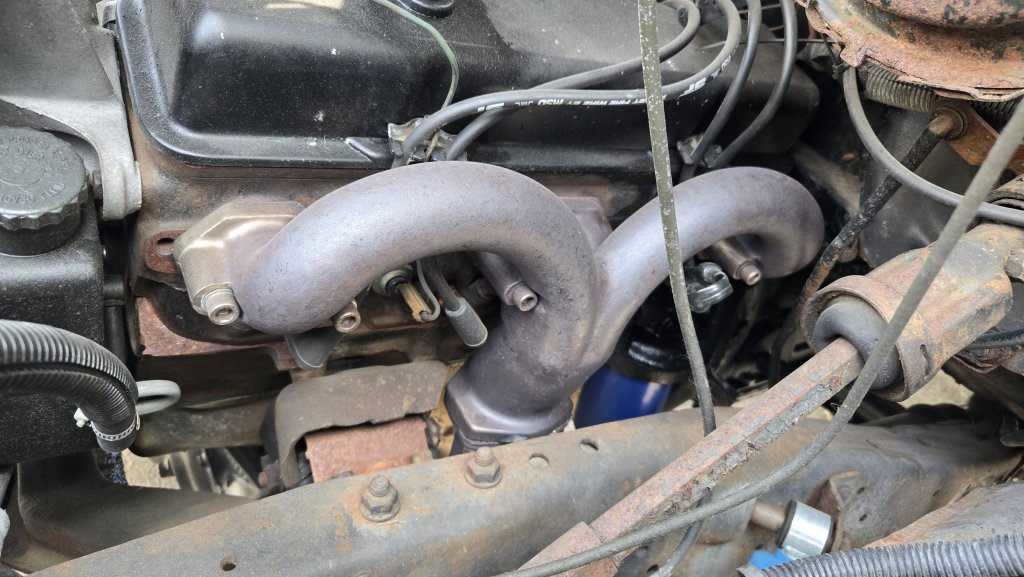

Here's the Hookers:

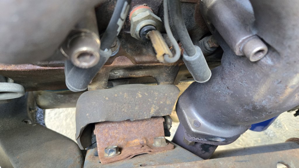

Driver's side from underneath.
The 1976 El Camino headers would not fit due to the 4wd axle on the passenger side.
Oil relocation would have been required to use them. So, once installed, it made sense to keep it, instead of running a cooler.
The Pipe wrap protects all the goodies better than expected on the 2 custom Down Pipes. (Not pictured).
Passenger side is way out over and past the starter. Using the fat style starter, (non-permanent magnets), would work no problem.
The smaller version starter from 94' (with permanenet magnets) has tons of room.
The bolts ar diagonal for the smaller starter. Every small block I have installed P-Mag, required at least one diagonal shim. My replacement 99' L31 engine requires 2 shims.
Some early blocks do not have diagonal starter bolt castings. You are stuck with the fat atsrter that can become heat soked and require replacement every year or two.
Choosing exhaust vs the fat starter is a definite issue you want to get correct.

Finally my plugs wires don't get burned from the Sanderson mistake, using the Hooker's.

The Blazer frame narrows, so Rams DP would get weird.
On the Pass side, it would super heat the frame and cook brake lines and starter wires using Rams. Not enough room, in my opinion.

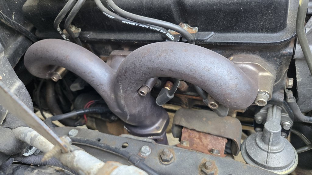

OEM Manifolds:
The frame is no where near as narrow as the Blazer.
Stainless?
(Every manifold eventually shows signs of rust, even stainless, unless it's 316 $$$$$).
You guys tell me what it is?
Very cool bends.
The only new engine part is the driver's side manifold gasket, best of my knowledge.
Starts on the first turn, lil' pedal.
72K original miles.
Notice the smog ports are all blocked off by the factory?
Now you see how the CHEAPER OEM castings evolved from these HQ factory manifolds.
Look at the engineering and quality of these compared to everything else out there?
Probably too much $ for production ?
