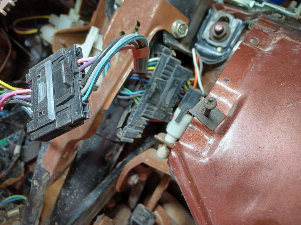

Looking for a bit of advice. I am looking to remove the steering column. Before I start pulling on the connections any advice on how to disconnect. Just trying to NOT break the connections.

The 2 connectors pictured there - turn signal switch & what looks like a wiper switch, but yours is an 81 - ?? will come apart when you push on that black tab and push them apart.
The 2 connectors for the ignition switch IIRC have a metal strip that holds them down - you can just pry that up slightly and lift them out.
If equipped, the cruise plug just , well - plugs in. LOL
You probably also have a reverse light/neutral safety switch at the bottom of the column closest to the firewall.

Thanks Goldie...I have it 90% removed. got the 2 smaller plugs that are on top of the column to undo. I wanted to take some pics for reference so I had to stop and grab phone....

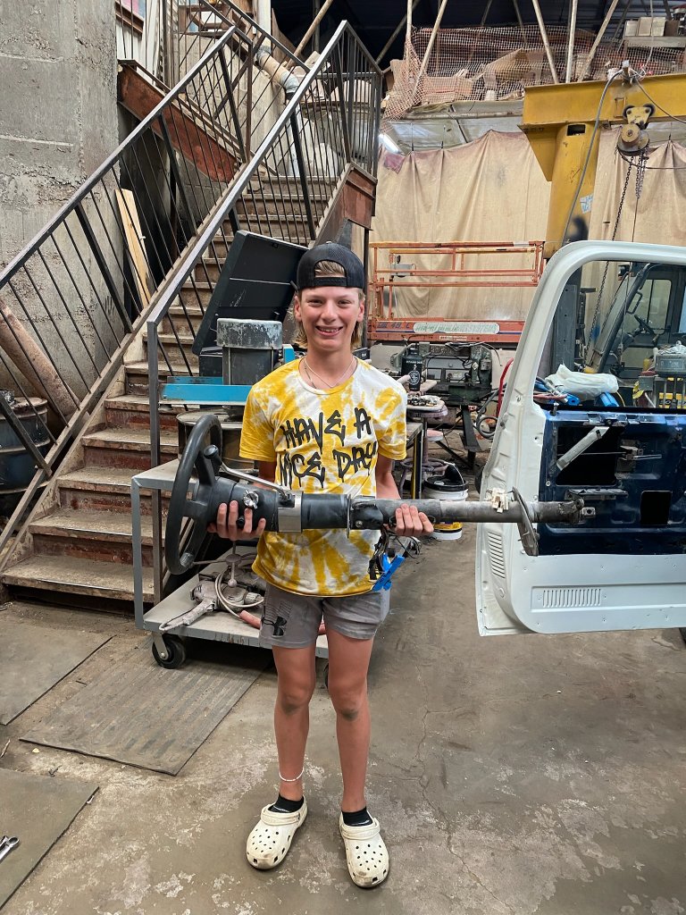

Ken, you mean the seal on the plate that connects to firewall? At end of column?

250
Yup.
Just not gonna tear into bottom of column.
